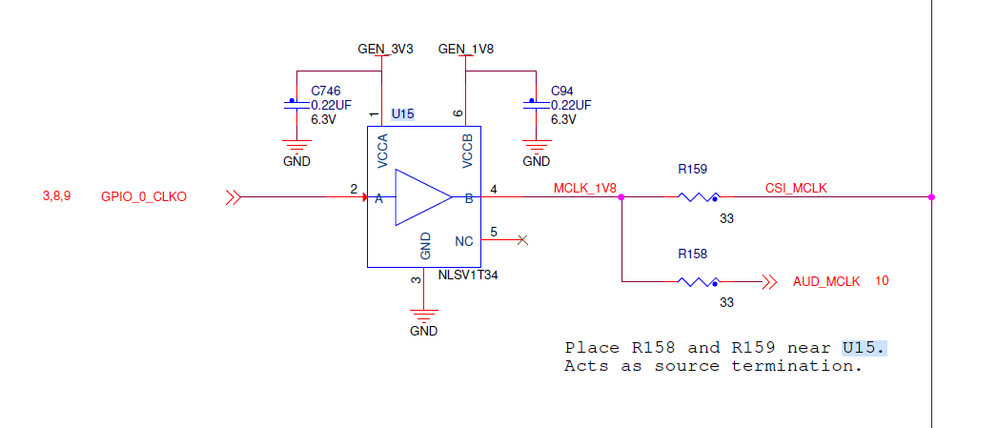

I am tring to take 27Mhz from IMX6 Sabresd board from GPIO_0_CLKO pin.
How can i do that? I guess 24Mhz is default set in DTS but i couldnt see any clock in this pin on ossiloscope? Do i need to change DTS also?

24MHz is defined in linux/arch/arm/boot/dts/imx6qdl-sabresd.dtsi :
ov564x: ov564x@3c
imx6qdl-sabresd.dtsi\dts\boot\arm\arch - linux-imx - i.MX Linux kernel
and one can test check this clock on NXP Sabre board with Demo Images from
i.MX Software | NXP
OV564x drivers are described in sect.6.1.2 Omnivision Camera attached Linux Manual.
For obtaining 27Mhz it is necessary to modify driver or better add CCM_CCOSR initialization to uboot,
set some suitable parent clock (probably changing some PLL frequency), so 27Mhz clock
can be divided from parent clock.

I even download sample images for older version (L4.1.15_1.0.0-ga_images_MX6QDLSOLO) for SabreSD, i cannot still see the 24Mhz on "GPIO_0_CLKO".
Do you want me to test spesific version of kernel that CSI_MCLK is generated correctly?

MCLK configuration can be debugged in camera driver, for example in
linux/drivers/media/platform/mxc/capture/ov5640.c
ov5640.c\capture\mxc\platform\media\drivers - linux-imx - i.MX Linux kernel
Linux configuration is described in sect.6.1.2 Omnivision Camera
Uboot MCLK (CKO1) configuration example:
uboot-imx/tree/board/toradex/colibri_imx6/colibri_imx6.c
colibri_imx6.c\colibri_imx6\toradex\board - uboot-imx - i.MX U-Boot
igor

I am using i.MX6Q Sabre SD evaluation board. I ve just download the image and create a sdcard from it.
But i cannot see the CSI_MCLK on the above pin. Actually i dont have camera module(OV564x) so it is not connected to board.
I simply want to see 24Mhz (then i will try to see 27mhz) CSI_MCLK pin(GPIO_0_CLKO).

suggest to connect camera module and then check CSI_MCLK.
Alternatively you can try to configure it in uboot, as in above example.

Now i can see the 27mhz clock on the pin but clock is getting down when kernel started.
I guess one of the driver resets the CSI MCLK. This is base kernel code there is no update or any module on that.
How can i fix this?
