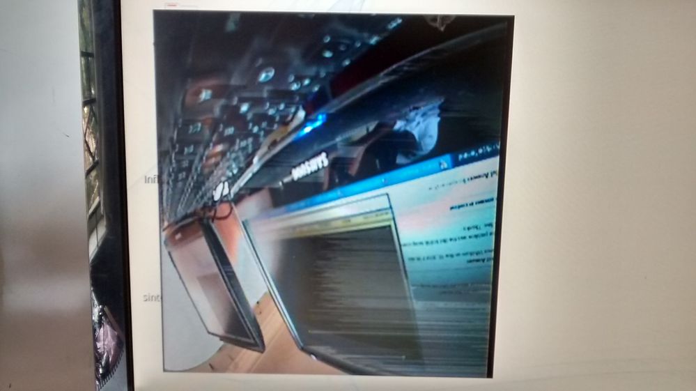

yennivenkateswa
hi,
please observe these images, in this images some noise is there.
can you please tell me,why blur images are coming from my analog camera ?
and can you please tell me is it hardware issue or my driver issue ?
Thanks&Regards

yennivenkateswa
hi Weidong sun,
when i run this command ./mxc_v4l2_tvin.out -ot 0 -ol 10 -ow 720 -oh 480 -m 2 without connect analog camera blue screen is coming. once i connect camera blur video coming.

weidong_sun
Hi venkatesh,
    could you paste a picture of your video here, let me see it .
Weidong

yennivenkateswa

yennivenkateswa
hi,
i am using adv7180 driver as a reference
modprobe adv7180_camera
modprobe mxc_v4l2_capture
cd /unit_tests
lucid@lucid-desktop:/unit_tests$ ./mxc_v4l2_tvin.out -ot 0 -ol 10 -ow 720 -oh 480 -m 2
problem is iam getting blur video,can you please tell me why like this it is coming?
Thanks&regards
venkatesh
3,581 Views
weidong_sun
Hi Venkatesh,
     It seems that the issue is generated by CVBS input, blue video means that ADV7180 has been working , so you should check if there are some issues with analog camera input.
Weidong
