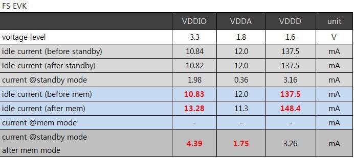

I have question IMX28 Board current issue after mem mode.
We are testing to standby mode and mem mode on IMX28 board.
In cpu clock 454MHz case, idle status board current is 86mA.
But , Entry to mem mode and after wake up board, board current is 94mA.( more up to 10%)
i want know Why that increase power current??
what is difference befor mem mode and after mem mode?
customer project is mobile phone application., so power consumption is very important.
please help us.
thanks.

so called "mem mode" is not real low power mode, because
really i.MX28 is completely powered down, while state of its main
modules [really not all], CLKCTRL, PinCtrl are saved in DDR memory
[so called "context"]. From sect.3.6.2 "Suspend-To-RAM mode "
AN4199 Using the i.MX28 Power Management Unit and Battery Charger:
"In this mode, the i.MX28 is placed in the Power-Off state. The DRAM is placed in the Self-Refresh state,
and all the context and register values are stored in the DRAM to allow the device to wake up quickly on
resume. As the i.MX28 is in Power-Off state, the DC-DC converter is not active. Therefore, an external
power supply is needed for the DRAM. Only PSWITCH can be used to wake up the device from
Suspend-To-RAM mode."
Practical consequence from this solution is next: for example some device is
active after OS start-up. Then your application wisely decided to turn it off just before
entering "mem mode". However after exit from "mem mode" you will see that it is still
active and current is more, then just before entering "mem mode". This happened because
you should save in "context" state of this device. Exit from "mem mode" is cold start-up
event with restoring only data, which one saved in "context".
So suggestion to check what is saved in your "context", this depends on particular
application.

sung-ukjang
Dear Freescale.
I had check Current status.
Why difference before and after current status??
Just have entry mem-mode and wake up.
Please help.

igorpadykov
Hi Sung-Uk
sorry what do you mean by "mem mode" ?
In the original EVK design (i.MX28 EVK), DRAM power source is provided by the
on-chip power supply and it will be turned off during mem mode.
In order to support suspend to RAM, it must be connected to a constantly
on power source rather than the on-chip power supply.
So "mem mode" can not be tested on i.MX28 EVK.
Probably " IMX28EVM board" as you calls it - something else, not i.MX28 EVK.
So suggestion - please try measurements with board
without populated external components.
