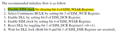

DK4509
Currently, we are designing the MCIMX6S5EVM10AD part number IMX 6 Solo CPU.
Question - 1
We planned to use the Input reference clock to the ACLK pin (EIM_ACLK_FREERUN) 104MHz to enable the EIM module.
Whether it is mandatory to source the external clock 104MHz to the ACLK clock to drive/enable the BCLK which it act as a reference clock for CPLD?
Please confirm once on the above point.
Question - 2
If so, we placed crystal oscillator externally to generate 104MHz continously is there any impact on BCLK genertaion.
Because there are few steps to enable the BCLK to work as in Synchronous mode, in that first step Disable the EIM clock was mentioned in the datasheet.
If we are using external cryctal oscillator the clock should be continous then the first step is not matching as per the datasheet recommendation. please confirm whether it is prefered to use the crystal oscillator externally for ACLK pin. Please suggest your comments.
