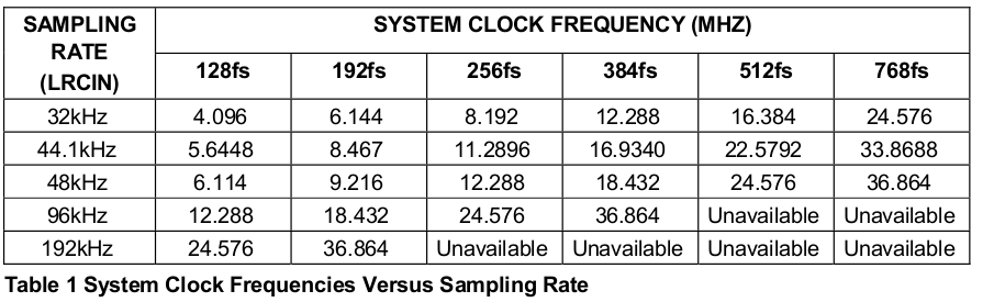

My codec  is a WM8740 and must be driven by an external clock. IMX can provide this oversampling clock with I2S master mode and SYS_CLK_EN=1.
I'm facing an issue with the fsl_ssi_set_dai_sysclk in fsl_ssi.c which is not calculating correctly the sys clock according to the bitclock requested.
When asking 2822400 which is 44100 * 2 * 32, the sys clock which is calculated is too high(79Mhz instead of 11.2896MHz) as PM (13) for common use of codec such as WM8740.

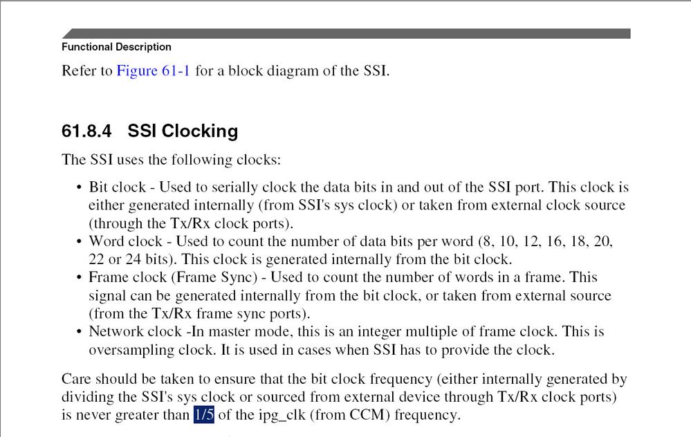

this restriction is from IMX6DQRM  sect.61.8.4 SSI Clocking

I still dont anwser why its forbidden to have a bitclock greater than 1/5 of the ipg_clk. I have read this caution in documentation.
In my case, in order to get a working 192kHz sample rate, i need 24.576MHz or 36.384MHz (WM8740 Table) as sys clock and 32 *2 * 192000=12,288MHz as bitclock.
So in this case, ipg_clock=24.576MHz and pm=0.
I have been working like this for about a year with previous kernel 3.0.35 without any issues.

this is forbidden due to processor harwdare design,
that is internal SSI module synchronization is guaranteed provided that
that requirement is fulfiled.
~igor

SSI hadrware forbids to have a bitclock greater than 1/5 of the ipg_clk.
This is described in RM.

I read it in the RM too.
I'm sorry to insist but what are the consequences if i dont take this limitation into account?
In table 61.7 in IMX6QDRM.pdf, there is this line where pm is equal to 1 and so bitclk/ssi_sys_clk is equal 1/4 so greater than 1/5

consequences may be that is some
corner PVT cases it may work unpredictable.
table/software comments may be inaccurate, since these
may be left from previous processors docs.
