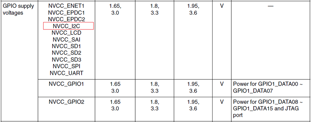

I tried to find the DC specification for the I2C pins through the "i.MX7Dual Family of Application Processors Datasheet (IMX7DCEC)" siince I need to fix the pull-up resistor value of the open-drain I2C port. However, there is no description abou this DC specification in this datasheet.
Could someone please tell me which document I should refer to.

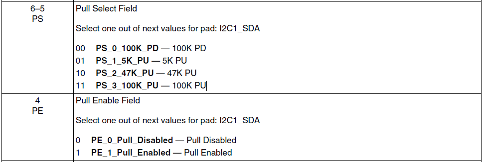

One more thing, is it possible to configure the internal pull-up resistor for the I2C port which may apply the device tree option like a GPIO port ?

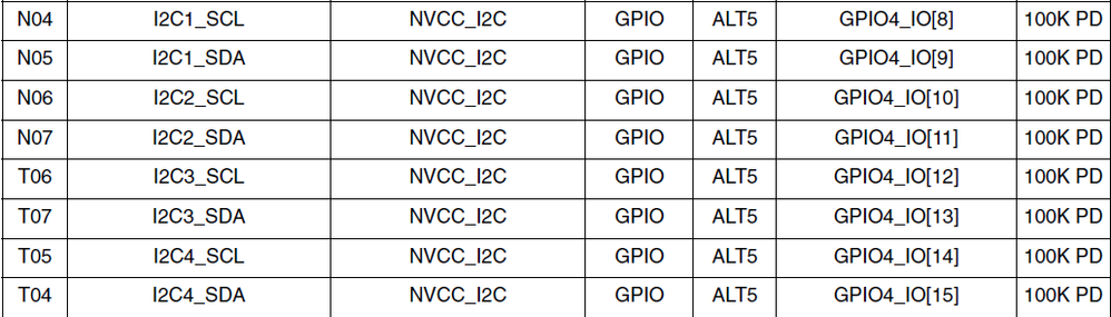

   Let me take I2C in i.MX7D-SDB board as examples.
---From design files
From datasheet:
So pads max rating of I2C is 3.6V, and typical is 3.3V, 1.8V.
---From Reference Manual:
I2C1_SCL PAD control register: IOMUXC_SW_PAD_CTL_PAD_I2C1_SCL
So I2C1_SDA pad can  be pulled up / down.
I2C1_DAT PAD control register: IOMUXC_SW_PAD_CTL_PAD_I2C1_SDA
So I2C1_SDA pad can also be pulled up / down.
For other I2C pads, usages are the same as above.
