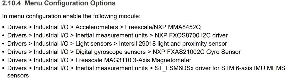

Please make sure these configs are enabled in kernel defconfig.
To read the sensor data, please refer this case, access /sys/bus/iio/devices/iio\:device0/ node in sysfs.
https://community.nxp.com/t5/i-MX-Processors/How-to-read-iio-device-in-user-space/m-p/733081
