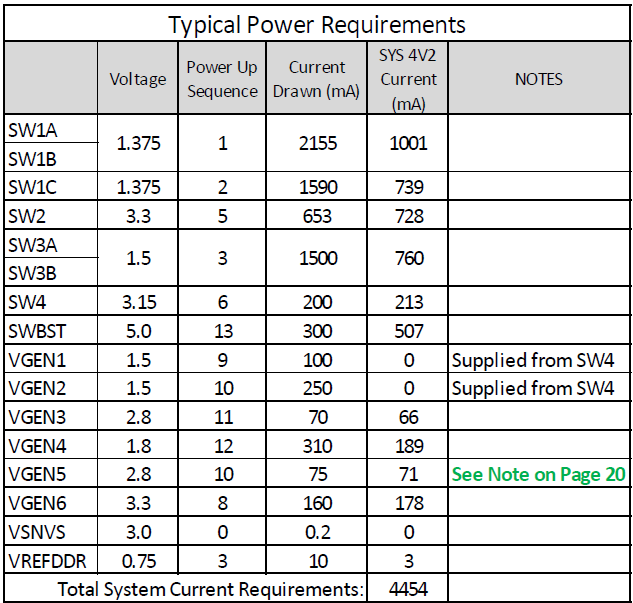

I want to know power sequence of MCIMX6Q6AVT10AC and MMPF0100NPEP that is power up sequence graph.

     MMPF0100NPEP(Programmed as F0 configuration for I.MX6Q) is empty, customers should do OTP(One Time Program) for it. See following , please!
(1) Power On Sequence of F0 configuration(you can see it in schematic of MXIMC6Q-sabreSDP board)
(2)Configurations of MMPF0100
More details , please research documents of MMPF01000 and I.MX6Q
