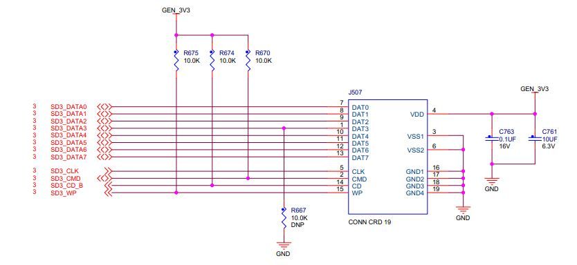

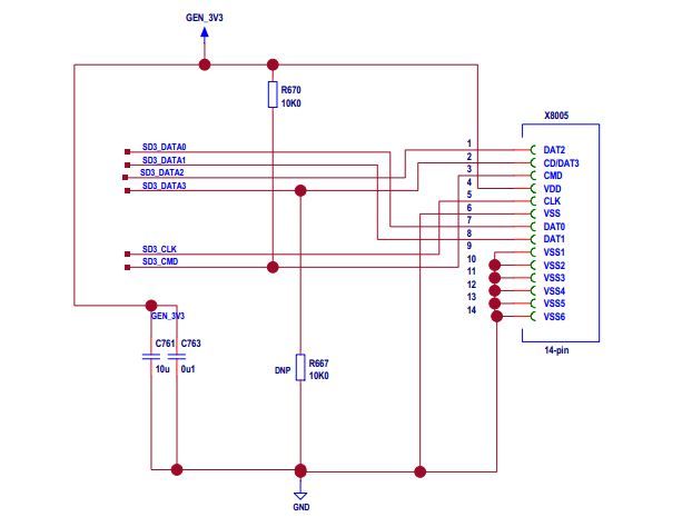

Hello, Freescale
Our hardware board design is mostly based on the SabreSmart Board( CPU use Dual, DDR3 same, Ethernet same,etc), but the sd card circuit design is different.
We use the micro-sd card which is the same with Sabre-Lite hardware design, and our board is only supported by booting from SD3.
Here is the circuit design difference:
Our Board design:
SabreSmart Board Design:
The SD3 data line, we only use 4 data line. My u-boot baseline is the SabreSmart.
My question is what should I changed from this circuit design changed based on the sabresmart uboot codes?
Thank you for your strong support!

justin_jiang
1. Remove unused pin IOMUX setting in the code.
2. The boot device is selected by boot fuse. You can check the fuse table for SD boot. It can boot in 1-bit or 4-bit mode.

laufei
Hello, Jiang Qingrong
Thanks for your very quickly reply!
1. The IOMUX setting whether is in this file  <asm/arch/mx6.h>? Can you help me locate this file?
2.  I checked the datasheet and our boot fuse table, we select the sd3 boot and -1 bits, 2 delay cells. with the same SabreSmart Board configure.
What I am confused is we connected  SD3_DATA0~4, while SDB connect SD3_DATA0~8, If it just use only 1-bits SD3_DATA0, the others SD3_DATA(1~7) are useless?
Best Ragards
Fe la
