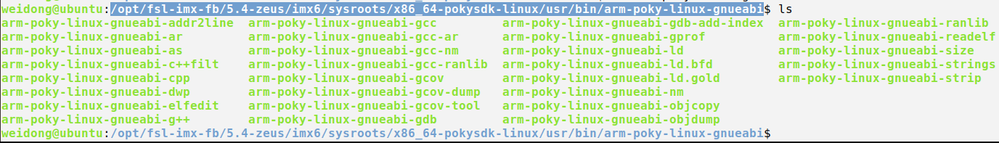

Hello NXP community,
I got some problem to install eclipse setup for sdk in yocto.
I have followed Setting up the Eclipse IDE for Yocto Application Development.
but, I can't click OK button in "Yocto Project ADT" and "Target Architecture" is disabled, so I can't forward to next.
I have input my path("/opt/fsl-imx-x11/5.4-zeus/sysroots/cortexa9t2hf-neon-poky-linux-gnueabi") as Toolchain Root Location, and "/home/yibhan/project/imx-yocto-bsp/build-x11/tmp/sysroots/imx6qpsabresd/imgdata" as Sysroot Location.
By the way, when I input Sysroot Loacation as "/home/yibhan/project/imx-yocto-bsp/build-x11/tmp/sysroots/imx6qpsabresd/imgdata", that path has only environment script(xxx.env).
Is that right?

As you have mentioned "Target Architecture" is disabled, can you please check once that have you enabled the Standalone pre-built toolchain radio button or not?
For Syroot location as suggested by weidong.sun you can use path of your expanded toolchain's sysroots  (<expanded_toolchain_diretory>/sysroots/<machine>).
We are able to build hello world (cpp project) with cortexa9hf-neon-poky-linux-gnueabi.
In sysroots path we are able to found below two machine's only. (not found environment script(xxx.env)).
  • cortexa9hf-neon-poky-linux-gnueabi
  • x86_64-pokysdk-linux

Hi  Yibeom Han,
     If you have exported toolchain and installed it in /opt directory, compiler is here:
/opt/fsl-imx-fb/5.4-zeus/imx6/sysroots/x86_64-pokysdk-linux/usr/bin/arm-poky-linux-gnueabi
If you use Eclipse and ADT plugin, probably you should specify absolute path of cross compiler.
I don't recommend that you use compiler in "yocto/build/tmp/...." , Because this is a temporary path when compiling the BSP.
Try it , please!
