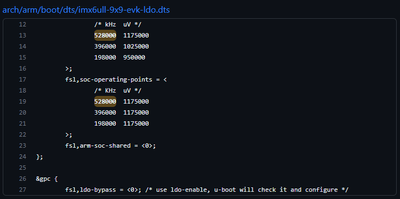

I understand that it's working from you created case, please refer to IMX REFERENCE MANUAL page 33.
If the frequency is not defined in DTS, the CPUFREQ driver changes the CPU frequency
to the nearest higher frequency in the array.
The initial clock speed is 528 MHz, then you change it to 530 MHz, the nearest defined frequency is 900 Mhz, same for the other command.
What is really concerning is your reply, it doesn't get back to 528MHz.
To set the clock to 792 MHz you have to set up that option in the device tree, see the next example.
Thank you

It appears that 792000 is already defined in device tree in cpu0.
Here is the live device tree for imx6ull-14x14-evk:
root@imx6ullevk:/proc/device-tree/cpus/cpu@0# xxd -g4 fsl,soc-operating-points
00000000: 000dbba0 001312d0 000c15c0 0011edd8  ................
00000010: 00080e80 0011edd8 00060ae0 0011edd8  ................
00000020: 00030570 0011edd8                    ...p....
root@imx6ullevk:/proc/device-tree/cpus/cpu@0# xxd -g4 operating-points
00000000: 000dbba0 00137478 000c15c0 0012b128  ......tx.......(
00000010: 00080e80 0011edd8 00060ae0 000fa3e8  ................
00000020: 00030570 000e7ef0                    ...p..~.
0x000c15c0 =  792000
0x0011edd8 = 1175000
0x0012b128 = 1225000
Should I delete all the other operating points except 792000?
