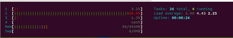

When i am running video locally on board using gplay it is able to play videos upto 1080p very smoothly.When i am using freerdp protocol for multimedia redirection(Decoding done by imx6q) there is audio and video lag.But i am able to play low quality videos with small resolution on imx6q smoothly.
When i am running the  Video on target board I have noticed that total load is going on 1 core only.can you tell me how to distribute load on 4 cpu's. rdp.png
