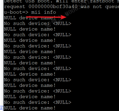

I am using a DP83848 TI chipset for ethernet and not able to detect the chip, Can any one help me how to read the registers using MDIO line in I.MX8MP
error:
Error: ethernet@30bf0000 address not set.
No ethernet found.
u-boot=> mii info
NULL device name!
No such device: <NULL>
NULL device name!
NULL device name!
NULL device name!
NULL device name!
NULL device name!
NULL device name!
NULL device name!
NULL device name!
u-boot=> mii read 0-1 0-6
NULL device name!
Error reading from the PHY addr=00 reg=00
NULL device name!
Error reading from the PHY addr=00 reg=01
NULL device name!
Error reading from the PHY addr=00 reg=02

Zhiming_Liu
HI @JasonShu

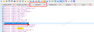

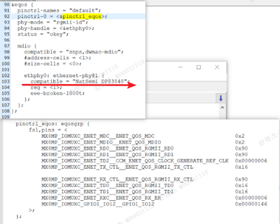

Please port or use the phy driver based on drivers/net/phy/natsemi.c.
You can modify the eqos pinctrl node but this is decided by your hardware design.
Then define the phy node under eqos
&eqos {
	pinctrl-names = "default";
	pinctrl-0 = <&pinctrl_eqos>;
	phy-mode = "rgmii-id";
	phy-handle = <&ethphy0>;
	status = "okay";
	mdio {
		compatible = "snps,dwmac-mdio";
		#address-cells = <1>;
		#size-cells = <0>;
		ethphy0: ethernet-phy@1 {
			compatible = "NatSemi DP83848";
			reg = <1>;

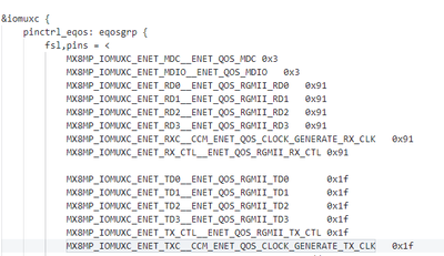

JasonShu
Hi Zhiming
I modified the eqos pinctrl node according to my hardware design
add the config
Unable to recognize network
Can you give me some advice on how to troubleshoot?

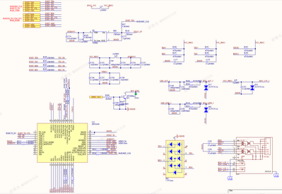

Can you share your eth hardware design?
2,486 Views
JasonShu
Hi Zhiming
This is my eth hardware design.
Best Regards
Jason

Zhiming_Liu
Hi @JasonShu
Why do you modify  IOMUXC_SW_PAD_CTL_PAD_ENET_X registers value in dts node?
This will adjust drive strength, do you need it?
The default REF clock is set in board/freescale/imx8mp_evk/imx8mp_evk.c, you need use 50Mhz refer DP83848 datasheet.

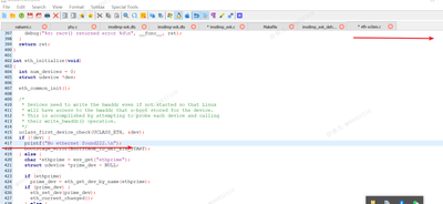

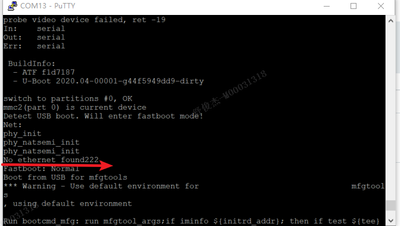

2,470 Views
JasonShu
Hi Zhiming
I modified  IOMUXC_SW_PAD_CTL_PAD_ENET_X registers value as imx6ull.
and the error always  occurs
error:No ethernet found
I have located it here
why can not found device? can you give me some advice?
Best Regards
Jason

Zhiming_Liu
Hi @JasonShu
Please use below value in i.MX8MP dts
On EVK platform, arch/arm/dts/imx8mp-evk-u-boot.dtsi will cover imx8mp-evk.dts  and modfiy eqos driver name: "fsl,imx-eqos".
&eqos {
	compatible = "fsl,imx-eqos";
	/delete-property/ assigned-clocks;
	/delete-property/ assigned-clock-parents;
	/delete-property/ assigned-clock-rates;
&ethphy0 {
	reset-gpios = <&gpio4 22 GPIO_ACTIVE_LOW>;
	reset-assert-us = <15000>;
	reset-deassert-us = <100000>;
Please modify based on arch/arm/dts/imx8mp-evk-u-boot.dtsi

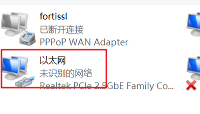

1. The device information can be displayed now, but cannot ping the network.
2. Using a direct connection method, the PC shows that the network is not recognized.
3. How should I investigate next?
