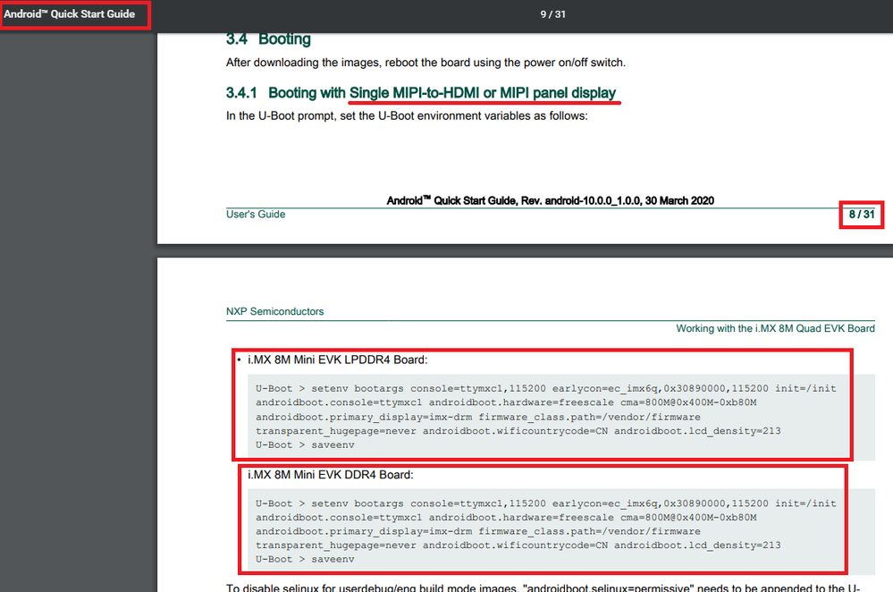

and the U-Boot prompt setting env to this:
setenv bootargs console=ttymxc1,115200 earlycon=ec_imx6q,0x30890000,115200 init=/init androidboot.console=ttymxc1 androidboot.hardware=freescale cma=800M@0x400M-0xb80M androidboot.primary_display=imx-drm firmware_class.path=/vendor/firmware transparent_hugepage=never androidboot.wificountrycode=CN androidboot.lcd_density=213
or
and must: saveenv
this command is
android_Q10.0.0_1.0.0_docs/Android_User's_Guide.pdf's one of them.

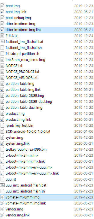

but I had a flashed to through UUU.exe what a dtbo and vbmeta .img File
look at the Screenshot:

Please download the Android 10.0.0.1.0.0 prebuilt images from this link. As shown in the below screenshot.
In this folder, you will find the images for the MIPI panel display as shown in the below screenshot.
Now, to flash the images using the uuu script, you need to apply the proper option. Please follow Section 3.3 and Table 2. Options for uuu_imx_android_flash tool Flashing board images of Android_Quick_Start_Guide.pdf attached herewith.
To use the MIPI panel display, you can flash the images through uuu using a below-mentioned command.
  • sudo ./uuu_imx_android_flash.bat -f imx8mm -t sd -d mipi-panel (To flash images in SD Card)
There is no need to set the bootargs as well.
I hope this will solve the problem.

Hi elim@sstd.co.kr‌,
You have to use dtbo-imx8mm-mipi-panel.img and vbmeta-imx8mm-mipi-panel.img images to use the MIPI Panel Display.
I have checked the Android 10.0.0.1.0.0 prebuilt images and I am able to get the display.
