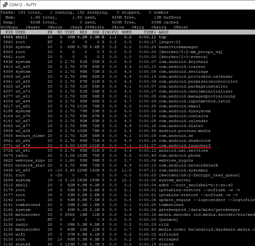

and this my board putty terminal screenshot:
look at the red line, Android launcher is alive.
how can I to the display wake up?

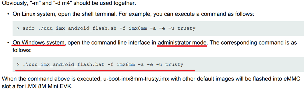

and I UUU.exe executed consult a manual guide:
My Computer CMD Screenshot:

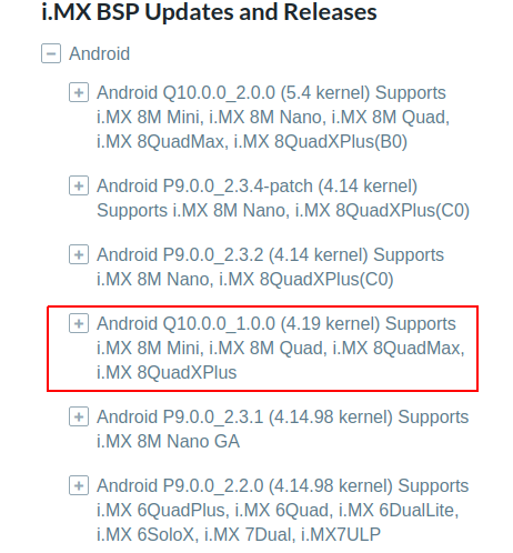

Which images you are using, Android 10.0.0.1.0.0 prebuilt images or Custom build images?
Please download the Android 10.0.0.1.0.0 prebuilt images from this link. As shown in the below screenshot.

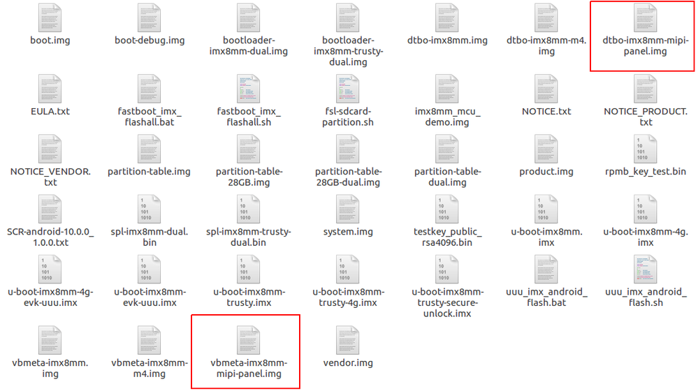

In this folder, you will find the images for the MIPI panel display as shown in the below screenshot.
Now, to flash the images using the uuu script, you need to apply the proper option. Please follow Section 3.3 and Table 2. Options for uuu_imx_android_flash tool Flashing board images of Android_Quick_Start_Guide.pdf attached herewith.
To use the MIPI panel display, you can flash the images through uuu using a below-mentioned command.
  • sudo ./uuu_imx_android_flash.bat -f imx8mm -t sd -d mipi-panel (To flash images in SD Card)

Hi elim@sstd.co.kr‌,
You have to use dtbo-imx8mm-mipi-panel.img and vbmeta-imx8mm-mipi-panel.img images to use the MIPI Panel Display.
I have checked the Android 10.0.0.1.0.0 prebuilt images and I am able to get the display.
Hope this will help you.
