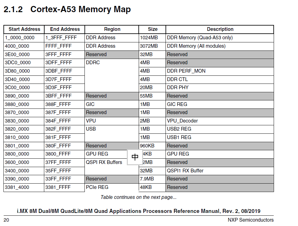

94393400
Hi Dylan,
        Which codes do you changed to confige the 4GB LPDDR4, I changed the codes , but always system_server native crash when use or do monkey test.
       what I change is below, please help to have a check. Many thanks.
native crash and low mem when take monkey test with LPDDR 4GB in imx8Mq evk
18,152 次查看
dylan_lin
Hi Zhulin
 Does your device have 4GB LPDDR4 , for per controller ?  or Totally ?
1. I check your RPA2_V24 document,the parameter is wrong , the I.MX8M maximum supports 24Gb , check RM           file   2.1.2 Cortex-A53 Memory Map
2. When you modify parameter of LPDDR4 , you should calibration it and stress it before you use monkey app
3. In addition , the LPDDR4 MR4 option in RPA_V24 should chooce option1 ,not automatic.
18,150 次查看
94393400
Hi Dylan,
     If I confige the 4GB DDR, how to change the codes in uboot and kernel?  I configed the 3+1 is correct or not?
      Many thanks.
18,140 次查看
dylan_lin
Hi  Zhulin
The I.MX8M only support totally 24Gb density,it means only support 3GB density,if you use more density dram,only 3GB can use ,other density are not useful,you can check RM file "Dram Memory Map" to double check memory address,
so your code ( bootloader & kernal ) should modify correct dram density.
18,136 次查看
94393400
Hi Dylan,
1. the RPA2_V24 should confige to 24GB ?
2. so your code ( bootloader & kernal ) should modify correct dram density.    how to change the bootloader & kernal codes?
18,152 次查看
94393400
Hi Dylan,
        Thanks for your reply,  the 4GB LPDDR4 of our device is Total , about the 3 points you refer to, the 2rd and 3rd , we have modified, do calibration and stress , also chose the option1.
   But the 1st point I can not follow , you said " the I.MX8M maximum supports 24Gb , check RM           file   2.1.2 Cortex-A53 Memory Map"
    It means that I.MX8M can't support 3GB?     RM  file   2.1.2 Cortex-A53 Memory Map ,   how to config the parameter of  RPA2_V24 document,Total DRAM density (Gb) only can set 24GB?
18,152 次查看
