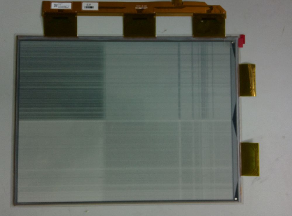

We have a problem with the ED133UT2 EPD display using the iMX7D.
1) Screen is connected to the iMX7D
2) From NXP we have received the file epdc_ED133UT2.fw which we uploaded to / lib / firmware / imx / epdc /
3) In the file mxc_epdc_v2_fb.c we have configured our screen
static struct fb_videomode config2_mode = {
.name="ED133UT2",
.refresh=75,
.xres=1600,
.yres=1200,
.pixclock=80000000,
.left_margin=20,
.right_margin=56,
.upper_margin=4,
.lower_margin=7,
.hsync_len=4,
.vsync_len=1,
.sync=0,
.vmode=FB_VMODE_NONINTERLACED,
.flag=0,
static struct imx_epdc_fb_mode panel_modes[] = {
&config2_mode, /* struct fb_videomode *mode */
4, /* vscan_holdoff */
10, /* sdoed_width */
20, /* sdoed_delay */
10, /* sdoez_width */
20, /* sdoez_delay */
796, /* GDCLK_HP */
481, /* GDSP_OFF */
0, /* GDOE_OFF */
39, /* gdclk_offs */
1, /* num_ce */
(These parameters we received from nxp)
4) Our framebuffer configuration now looks like this.
# fbset
mode "1600x1200-0"
# D: 0.013 MHz, H: 0.007 kHz, V: 0.006 Hz
geometry 1600 1200 1600 2560 16
timings 80000000 20 56 4 7 4 1
rgba 5/11,6/5,5/0,0/0
endmode
Unfortunately, we have "strange" lines on our screen.
What could cause this?

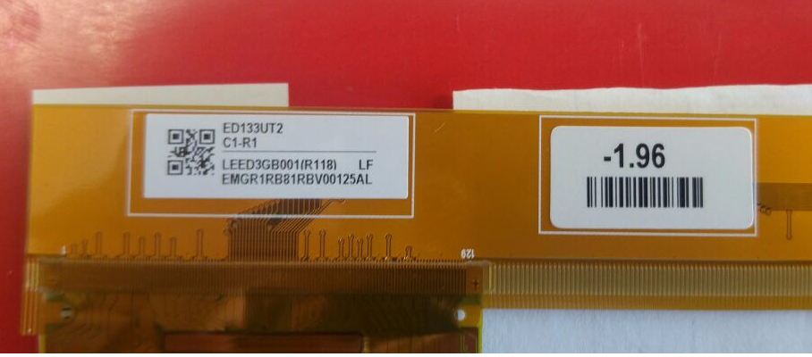

arsadhusainmomi
I'm working on a i.MX7Dual SABRE board with X-IMXEBOOKDC4 daughter board, trying to get the 13.3"  E-ink display working.
My display model is ES133UT2. I'm connecting the display on J2 header of the daughter board. I received the epdc_ES133UT2.fw from nxp, which I've placed in /lib/firmware/imx /epdc/.
My case:

I found out about the changes I need to make from the threads
I.MX7Dual - EPDC ED133UT2 - display problem
i.MX7D - EPD ED133UT2 - Display problems
Still the 13.3" is displaying weird things.
Not even the boot splash is coming up.
I tried the epdc unit tests and my own tests with similar results.
I also tried running it on 6" configs and its respective waveform like roberto pozzi did, still no luck.
I'm not sure what's wrong here.
People having similar problems please help asap.

Please note that I'm working with the eink panel ES133UT2 which is the same as the ED133UT2 (glass substrate instead of plastic) so I have changed the name of variables.
From NXP we have received the file  320_R118_AD5B01_ED133UT2C1_TC.fw which we uploaded to /lib/firmware/imx / epdc/

I have exactly the same problem. Here is my eink display label
6,403 Views
gusarambula
Hello Roberto Pozzi,
Is your EPD also showing random lines on the image? Would you please share a screenshot? Which configuration are you using and, would you please provide the num_ce if you have it?
If possible, would you also please share the connections between the board and the EPD?
Sometimes a possible workaround is saving to the framebuffer twice, which somehow helps the strips disappear.
6,403 Views
