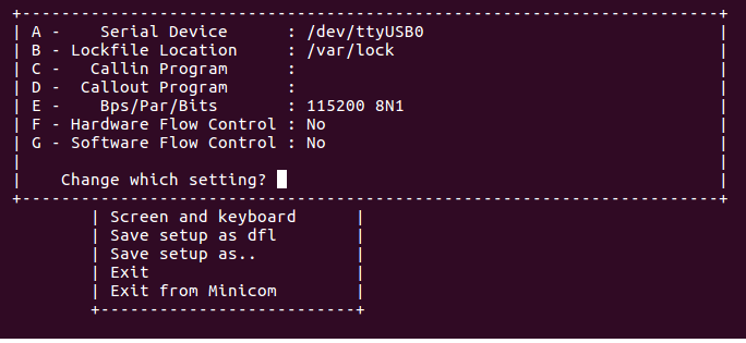

I'm trying to use I.MX6ULL but i have a problem of minicom
It is i connected board with SD card which has booting image
And than i run minicom and do setting like that
after setting i did run minicom again to connect with my board but when i run minicom i could not connect with my board like that

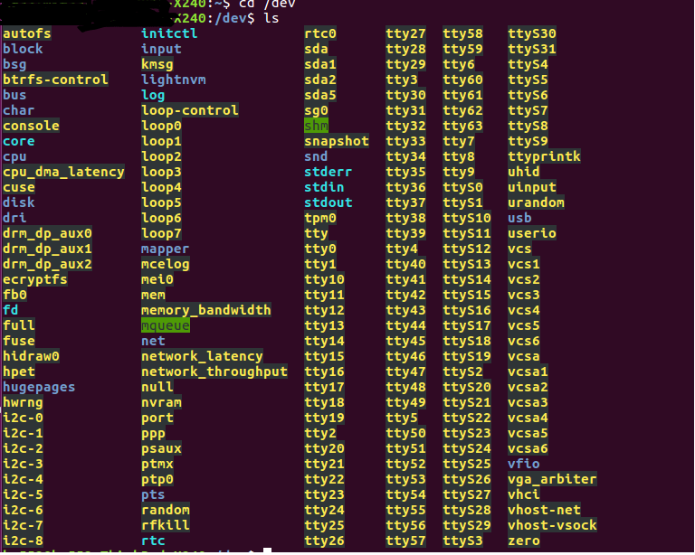

Also, i could not find 'ttyUSB0' in the /dev
Now, i am expecting SD card doesn't have exact booting image or use another USB Port

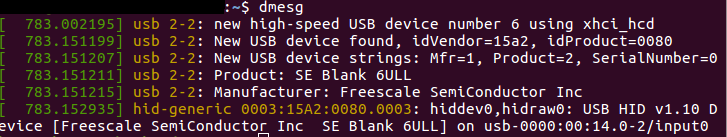

Hi Shinbok KIM,
Hope you have connected USB Debug cable to J1901 on the base board (mentioned in Quick start Guide for imx6ULL).
