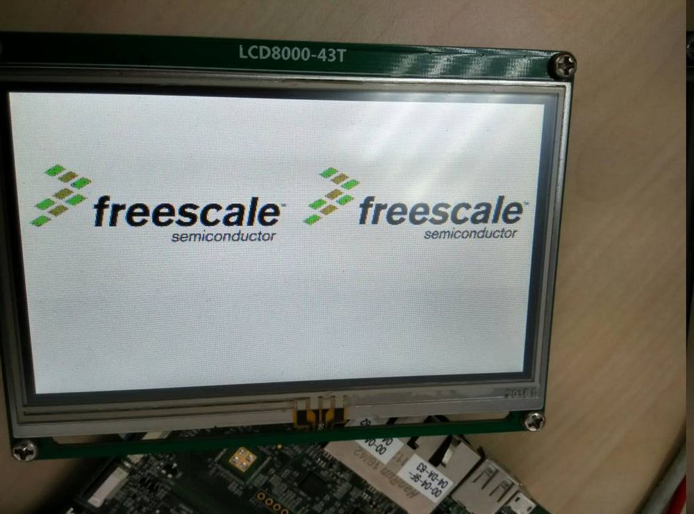

I am using i.mx6ull chipset with release fsl-yocto-L4.9.11_1.0.0. I would like to implement framebuffer image rotation (90 degree) using PXP. I manage to run imx-test/Display/pxp_test.out demo on EVK. Below are the snapshot of image for no rotation, with command: .pxp_test.out -I "-o/dev/fb0 -r0"
rotation_00.jpeg Diagram 1

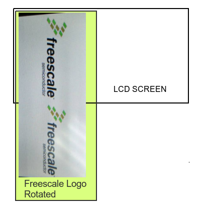

When I executed rotation of 90degree with command: ./pxp_test.out -I "-o/dev/fb0 -r90", I would expect the image is rotate 90 degree, with a section of the image fall outside of the LCD screen, as shown below.
simulate_rotate90_crop.pngDiagram 2

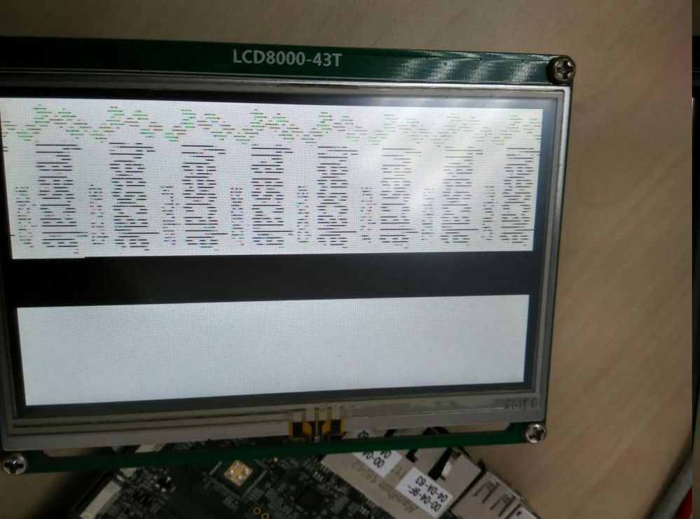

But in actual the output is shown as below.
rotation_90.jpeg Diagram 3
We tried to modify the parameter in the pxp_test.c(especially on width, height of srect/drect/s0_param parameters) to try achieve of Diagram2 but it is unsuccessful.
Kindly advise what changes is require in code to get output as in Diagram 2.

igorpadykov
Hi tk
I am not aware of documentation for usage pxp library, but
possible rotation shifting is described in sect.41.3.25 Rotation
i.MX6ULL Reference Manual in "NOTE" on p.2514
http://www.nxp.com/docs/en/reference-manual/IMX6ULLRM.pdf
igor

I found another pxp example(pxp_v4l2_test.out) in the imx-test, which is working. Command i use as below:
pxp_v4l2_test.out -sx 240 -sy 400 -res 400:80 -dst 0:0:240:400 -a 0 -w 2 -f 1 -r 270 daisy-400x240-565.rgb BLANK
