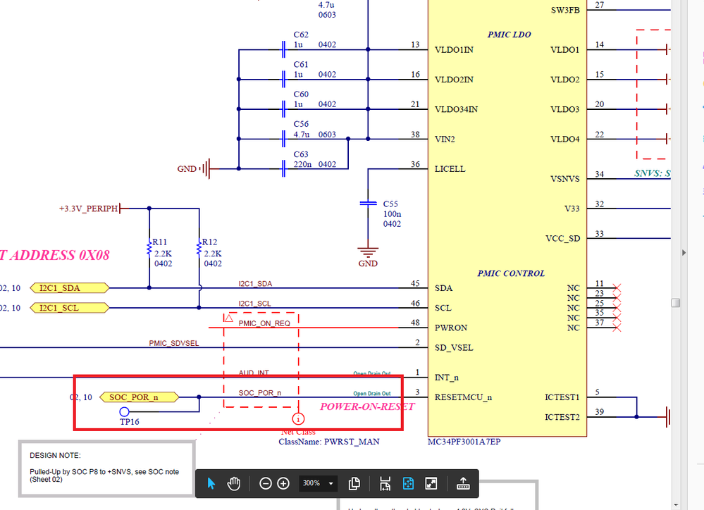

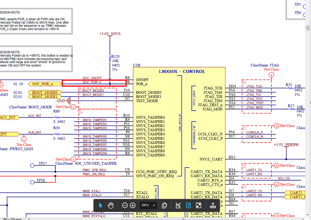

I.MX6 Ultralite pullups PORn to +SNVS Internally with weak 100k Pullup Resistor
Our PMIC PF3001A7 PORn output its open drain
So the SoC pullups this line

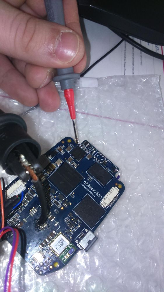

If i place the Agilent U1257B multimeter or Scope probes over SoC POR_n Testpoint the Soc Resets!
I also Added external 10k pullup to SNVS but This till ocurs
Any idea?

Is there a capacitor on POR_N on your board?
NXP board contains 100n capacitor of the POR_n.

Every time y connect multimeter probe to Testpoint I always connect the other probe to solid and robust Board GND

Maybe SNVS is high impedance because it has too low output current capabilities

nachodiz
Ok I will check
We´ve purchased this Agilent U1252B Last Week
So I think that it´s not broken :smileyhappy:
I detected the following behaviour :
- If i place multimeter probes between GND and TP16 (PORn Testpoint) when system is  OFF and then I power on the board it boots properly
- If i place multimeter probes between GND and TP16 when system is ON it reboots, but if I keep the probe over TP16 it continues working
- If i place multimeter probes between GND and TP16 when system is ON it reboots, but if I keep the probe over TP16 it continues working, but if i remove probes and place probes again, system reboots!
