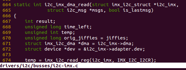

I configure the dts as follow(yocto version is 4.1.15_2.0.0), but i2c dma also couldn't be used:
1000             i2c3: i2c@021a8000 {
1001                 #address-cells = <1>;
1002                 #size-cells = <0>;
1003                 compatible = "fsl,imx6ul-i2c", "fsl,imx21-i2c";
1004                 reg = <0x021a8000 0x4000>;
1005                 interrupts = <GIC_SPI 38 IRQ_TYPE_LEVEL_HIGH>;
1006                 clocks = <&clks IMX6UL_CLK_I2C3>;
1007                 dmas = <&sdma 9 7 1>, <&sdma 10 7 2>;
1008                 dma-names = "rx", "tx";
1009                 status = "disabled";
1010             };
187 &i2c3 {
188     clock_frequency = <400000>;
189     pinctrl-names = "default";
190     pinctrl-0 = <&pinctrl_i2c3>;
191     status = "okay";
192 }
How could I enable i2c dma for i.mx6ul?

Hi Zahom
please refer to Table 3-4. SDMA Channel Usage attached Linux Manual
for supported sdma modules. Unfortunately i2c sdma is not supported.
igor

Hi igor,
Thansk very much for your reply. I found dma functions in linux i2c driver code(i2c-imx.c), Does those functions we can't use?

Hi Zahom
what is full file name/location, as this may be for processor (like i.MX28) not using sdma
