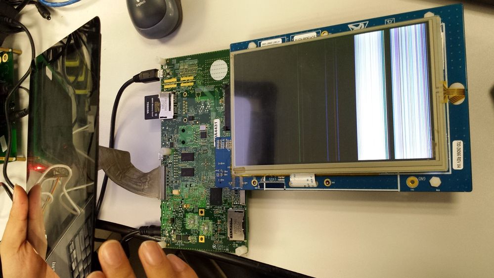

Requirement: LCD and LVDS1 output at the same time and display same content.
We uses a lot of way to configure uboot to make LCD output 800 x 480, LVDS1 output 1024 x 600. But it failed, only one display at one time.
Anyone could give me suggestion?

as we talked in mail, I think "video=mxcfb0:dev=ldb,LDB-XGA,if=RGB666 ldb=sin1 video=mxcfb1:dev=lcd,CLAA-WVGA,if=RGB565 video=mxcfb2:off" is good for your. we can fix this issue right now.

What are the bootargs that you tried?
873 Views
terrytan
Hello Carlos,
setenv bootargs console=ttymxc0,115200 androidboot.console=ttymxc0 vmalloc=400M init=/init video=mxcfb0:dev=ldb,LDB-XGA,if=RGB666,bpp=16 ldb=sin1 video=mxcfb2:dev=lcd,CLAA-WVGA,if=RGB565,bpp=16
Please check the picture attached for the hardware connection.
RGB LCD connect to Sabra SDB extend connector.
LVDS LCD connect to LVDS0.
874 Views

terrytan
Dear Joan,
Yes, it works, thanks for your help!
