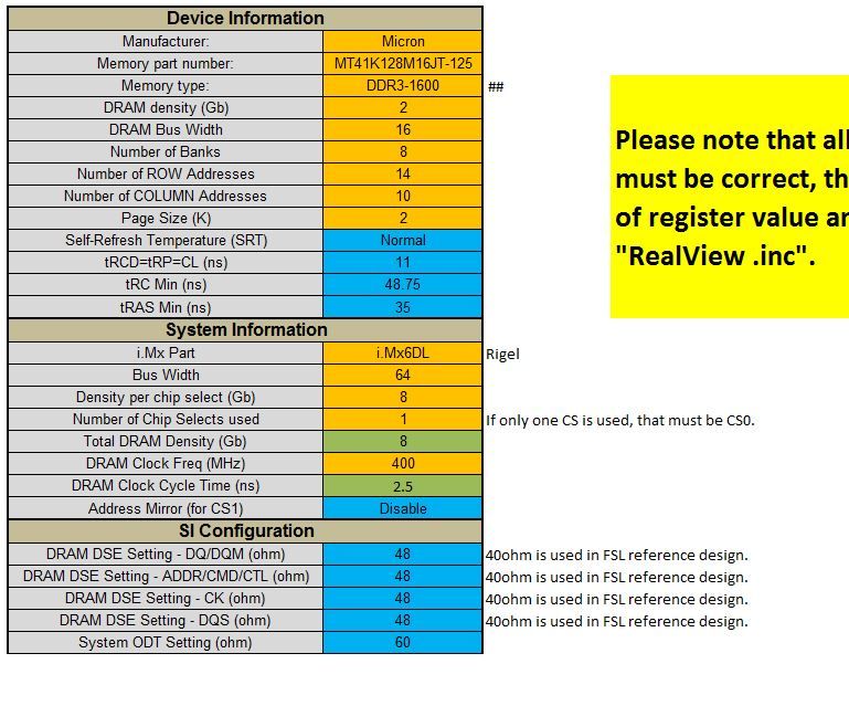

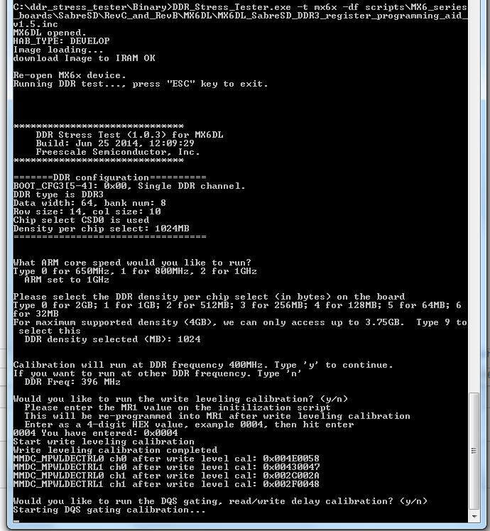

I am trying to run the DDR Stress Test on four samples of our custom board with no success. This is our first DDR3 board so I was hoping someone might be able to help me.
Hardware:
I.MX6DL 1 GHz
MT41K128M16JT-125 XIT (4 chips totalling 1 GB)
Software:
DDR Stress Tester Version 1.0.3
I.MX6DQSDL DDR3 Script Aid V0.10
It always hangs on the DQS gating read/write delay calibration, on all four boards. Any ideas as to where I should start?

We were able to pass the stress test by cranking the System ODT Settings up to 120 ohms.
Also, almost all of the boards boot into the Android OS now. The board we used as a reference design was the iMX6solo RIoTboard from Embest. In our design we switched to the iMX6DL but continued using the code base for the RIoTboard, modifying it to suit our board. I switched over to the code base for the SabreSD reference design and now almost all the boards we boot into the Android OS successfully.
Of course, we now have some new problems  but I'll save those for a new topic as these issues are solved.

Yuri
  Please look at some hints below.
1.
Please try to decrease memory frequency, using memory type (Script Aid),
another than “DDR3-1600”.
2.
Please check PCB design regarding DDR signals, using Chapter 3 (i.MX 6 Series
Layout Recommendations) of the “Hardware Development Guide for i.MX 6Quad,
6Dual, 6DualLite, 6Solo Families …”
http://cache.freescale.com/files/32bit/doc/user_guide/IMX6DQ6SDLHDG.pdf
In particular, please use to Excel page named “MX6 DRAM Bus Length Check” in
“HW Design Checking List for i.Mx6”, linked below.
https://community.freescale.com/docs/DOC-93819
3.
You may try to skip the calibration phase in order to check if further
tests can be passed.
4.
Please try to use WALAT = 1 in memory initialization script.
Yuri

mukelarvin
I tried doing the following:
  • Using a different PC.
  • Changing the memory type to DDR3-800. (400MHz is already the lowest clock frequency in the sheet.)
  • Using WALAT = 1.
... with no success.
My hardware guy assures me that he designed the board to the specifications of the hardware guides.
One of our boards can fully boot into android, two have a segmentation fault when starting the Zygote process, and the last board hangs on Freeing init memory: 260K.
To me that sounds like a hardware problem with the memory.
