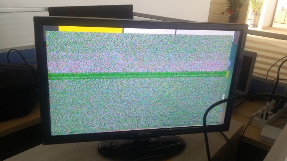

Dear All,
We are developing TVIN V4L2 Slave driver for TW8836 (Video codec Chip from I).
This VCODEC chip can output BT656 standard YCbCr (8bit) NTSC/PAL video standard.
In my schematic,
TW8836(VCODEC) ===connected===>IMx6q's CSI0 (CSI0_DAT12 : CSI0_DAT19).
It also has HSYNC & VSYNC Lines for video synchronization.

We further check that, I2C read/Writes are perfect and sensor configured for given values.
Also we measured, Pix-clock using scope i.e 27MHz (cool.. I believe it is as per standard).
Then, I tried using mxc_v4l2_tvin application as recommended as follows...
root@sabresd_6dq:/ # mxc_v4l2_tvin -ow 720 -oh 525 -ol 10 -ot 20 -f YUV422

Now what we can see is, a window is displayed with noise (may be white noise). I have updated screen snap shot (pleas check).
Can any one give me some hint. What could be gone wrong???   Please lemme know if more info needed...
Please help me....

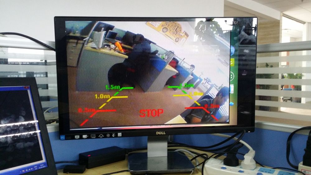

rajucm
Friends,
My V4L2 TVin driver is working. Its all about sensor configuration...^^
FAE gave me another set of tw8836 codec configuration and it just worked and now we can see video input.
Fortunately I myself answering my question :smileyhappy: (lol)
My Suggestions, Just follow tvin reference driver adv7180 given by Freescale and configure your sensor/videocodec chip with right values.
and run mxc_v4l2_tvin -ow 720 -oh 480 -ol 10 -ot 20. If it at all there is a problem, you can assume that its problem with HW or sensor configuration.
Make sure pclk(27MHz) and your input must be standard UYUV / YCbCr 4:2:2 NTSC / PAL.
Rajucm

rajucm
Dear All,
Some info,
as explained in De-interlace Capture Device I have applied add-csi-deinterlace-capture.patch.zip patch.
From logs evry thing looks ok. Isee propes Que & Dequeue Buffer.
But still I see white noise as uploaded in above pic.
Please gimme some pointer.....

I think it look like I am getting data from sensor....
mxc_v4l2_tvin directly dump the data to FB0,
Can any one tell me how to store this data in yuv file. So that at least I can play using YUV player and test.
any help would be appreciated...
Raju

Friends,
