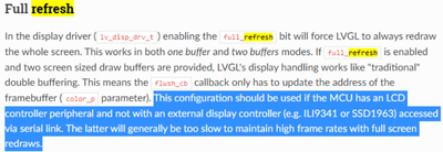

Hello, I review the example and I test it with the code I send and as same your test has the same results.
I was research more information about this and I found the next infdormation.
The full refresh mode should be used if the panel does not have external display controller accessed by MCU via serial link, as for the RK043FN02H-CT used in the demo. https://docs.lvgl.io/master/porting/display.html?highlight=rotation#display-driver"Pavel_Hernandez_0-1678818246408.png
And the example requires full refresh which does not support software rotation.
Therefore, it's confirmed that RT1060-EVK with RK043FN02H-CT panel doesn't support LVGL display rotation.
Pavel
