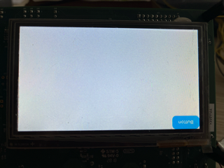

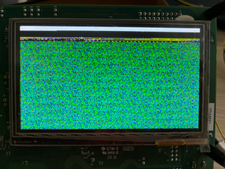

I have a kit with an imx 1060 processor that has the RK043FN02H display. I have downloaded the SDK for this processor and am trying to modify the LVGL guider example. I would need to rotate the display output to portrait. Currently, the display dump is in landscape. I tried adding the lv_disp_set_rotation(NULL, LV_DISP_ROT_90) function to the AppTask task, right after the initialization function. The result is a "blurry" image. The same thing happens if I set the angle to 270 degrees (LV_DISP_ROT_270). If I set the angle to 180 degrees (LV_DISP_ROT_180), the orientation of the dump is the same as if I had not used this function, yet the dump is supposed to be upside down.
What is interesting is that the button touch surface (coordinates) move to the correct positions, but the render does not.
Apparently there is some issue with the buffer rendering or transformation. Unfortunately, no matter what I try, I can't seem to resolve it. Therefore, I would like to reach out to NXP support and advice. Thank you.

I looked at the link and went through it, but I have to say I didn't come to anything. The only thing I could do was to rotate the display 180 degrees with the image rotated correctly, but I had to set full_refresh = 0. This resulted in the display flickering when I touched the button.
As you noted, this problem has been known about for some time. So who is solving this problem? Is there any other solution? Thank you.
lv_port_disp_init settings:
sw_rotate = 1; rotated = 1 | 2 | 3; full_refresh = 1; => BLACK SCREEN
sw_rotate = 1; rotated = 1 | 3; full_refresh = 0;
sw_rotate = 1; rotated = 2; full_refresh = 0;

Hello, I review the example and I test it with the code I send and as same your test has the same results.
I was research more information about this and I found the next infdormation.
The full refresh mode should be used if the panel does not have external display controller accessed by MCU via serial link, as for the RK043FN02H-CT used in the demo. https://docs.lvgl.io/master/porting/display.html?highlight=rotation#display-driver"Pavel_Hernandez_0-1678818246408.png
And the example requires full refresh which does not support software rotation.
Therefore, it's confirmed that RT1060-EVK with RK043FN02H-CT panel doesn't support LVGL display rotation.
