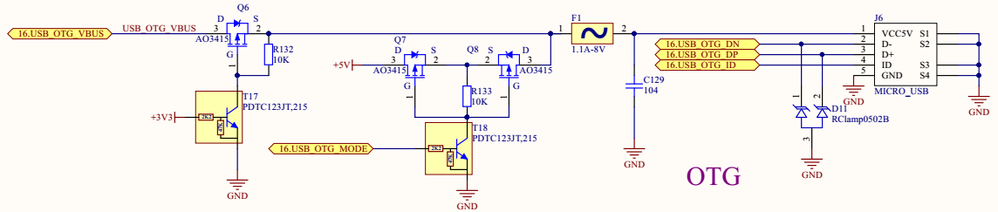

I need to use USB as gadget and Host mode also in imx6 sabresd board. by selecting USB_OTG how can do that if any one have an idea kindly share the details.

Hi Lavanya,
please show your usb otg diagram. i use this and it's working well
8,595 Views
nguyenmr
you can use USB OTG port for both host mode and device gadget mode. There are 2 signals you should care:
- USB_OTG_ID
- USB_OTG_MODE (control power for usb vbus in host mode, this is EIM_D22 pin)

 With above config, i can use OTG port for mouse, usb stick in host mode, and gadget mode for ADB...
