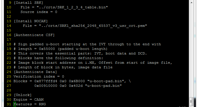

Follow the AN4581,
The customer use MFG tool still fail execute security boot, as below is related log.
local\mfgtool\Profiles\linux\OS Firmware\firmware\u-boot-imx7dsabresd_sd.imx
ModuleID[2] LevelID[1]: HAB type mismatch: 0x332233!!!
ModuleID[2] LevelID[10]: *********MxHidDevice[030096B0] Jump to Ramkernel successfully!**********
ModuleID[2] LevelID[1]: MxHidDevice::Write() Error writing to device 0x79.
ModuleID[2] LevelID[1]: RunPlugIn(): TransData(0x877FBFD4, 0x6BBC8,0x0) failed.
Could you provide document for i.mx7D?
Thanks.
Original Attachment has been moved to: csf_u-boot_yocto_mfg_3.10.53.txt.zip
Original Attachment has been moved to: MfgTool.log.zip

  It is needed also to sign u-boot for mfgtools firmware and sign mfgtool firmware zImage,
if use the MFG with closed i.MX device.
  Please create request to get more information.
