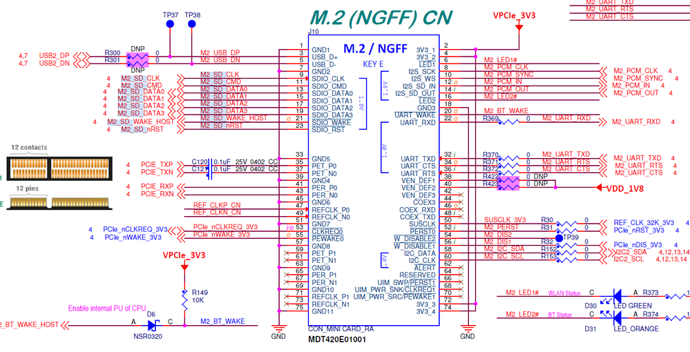

Dear
I want to bring up Wifi module by using SD/MMC (SDIO interface, use USDHC1 slot).
There is no usdhc1 part in the original kernel dts file.
So I have tried to change "imx8mm-evk.dts" of kernel but it seem is not work.
Attached file is modified file.(imx8mp-evk.dts).
Please check.
Best Regards
838 Views
jimmychan
Have you check the signals and voltage on your wifi module? Could you tell me which wifi module are you using?
Which version of BSP are you using?
Could you describe more about how it is not working?
How you loading the wifi driver and the firmware?
Is there any error message when the board boot up?
832 Views
dskim2
I builed Yocto version 6.1.22_2.0.0
Looking at the imx8mp.dtsi file, there is a usdhc1: mmc@30b40000 part, but the mmc@30b40000 part is not displayed when booting, and ifconfig mlan0 up is performed, ifconfig: SIOCGIFFLAGS: No such device is displayed.
below is the device booting log

817 Views
jimmychan
I think your wifi module is connected to the M.2 connector.
Please check the signals and the GPIO pins (IOMUX setting in dts file) are setting up properly.
