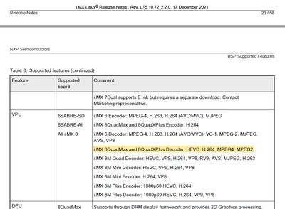

george
Senior Contributor II
Hello, @joanxie,
toshinariagata-san is my customer.
He wants to clear whether NXP's BSP supports jpeg decode by H/W for i.MX8X.
I found a related article on this Community.
https://community.nxp.com/t5/i-MX-Processors/Hardware-accelerated-JPEG-decoder-on-the-i-MX8X/m-p/952...
Igor has answered a similar question and he advises to ask professional support as the feature is not supported by the BSP.
According to the latest BSP release notes, it still doesn't seem to be supported.
Igor's article was a long time ago, but can I understand that current BSPs also don't support jpeg decode?
BR,
George
