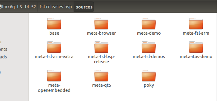

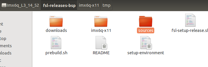

Hi Yuri,
  i read the "How to build the yocto SDK? " ,but i don't know how to build or add the yocto SDK in my linux ? can you tell me the steps ? thanks!
3,601 Views
Yuri
  the following may be helpful regarding Yocto approach :
Yocto Project Software Development Kit (SDK) Developer's Guide
Yuri.
3,601 Views
rothwanhuang
Hi Yuri,
  1.   I have the bsp of  imx6q_L3_14_52.and how to modify the conf file ? and how to bitbake <image> -c populate_sdk ?  the toolchain installer will be in tmp/deploy/sdk in the Build Directory."  thanks !
