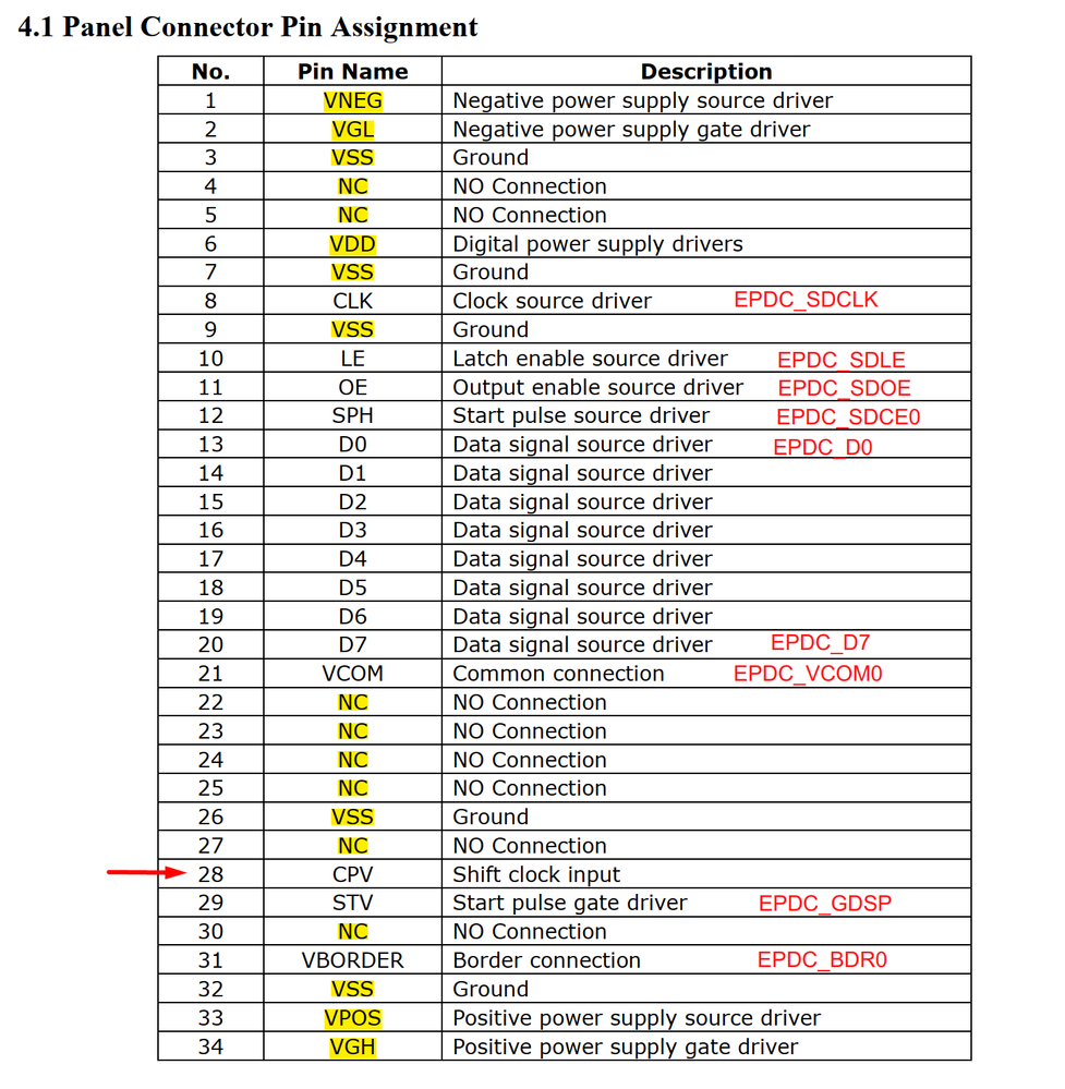

     I need to drive a EPD with the iMX6SLEVK.  I connect the pins to EPDC expansion port on iMX6SLEVK as follow .
      EPD  pins                                                        ------  iMX6SLEVK expansion port
      VCOM                                                              ------  EPDC_VCOM0
      BORDER                                                        ------  EPDC_BDR0
      D0~D15                                                           ------  EPDC_D0~EPDC_D15
      CKH(clock source driver)                                ------ EPDC_SDCLK_P
      LEH(latch enable source driver)                      ------ EPDC_SDLE
      OEH(output enable source driver)                  ------ EPDC_SDOE
      STH(start pulse source driver)                        ------ ?
     MODE1(output mode selection gate driver)     ------ ?
     STV(start pulse gate driver)                              ------ EPDC_GDSP
     CKV(clock gate driver)                                      ------ EPDC_GDCLK
Now,my questions :
1     There are two pins I don't know how to connect.
2     Is right the other pins out?
3    How to use the last some pins on EPDC expansion port on iMX6SLEVK like EPDC_PWRCTRL  EPDC_SDCE etc?
4   Where can I find the reference design of the IMXEBOOKDC3-E?
Thank you!

1. STH(start pulse source driver)    --------    EPDC_SDCE0
MODE1(output mode selection gate driver)  --------    EPDC_GDRL
2. Yes, this is right.
3. Just leave them floating.
4. This documentation is not publicly available due to NDA with E-Ink.

1,453 Views
Ryder
Thanks for your great topic and support
According to this topic, I have successfully connected my EPD to the IMX6SLEVK, except for 1 pin
It's called CPV(Shift clock input), pls check the attached image for a more detailed description
Could you please check and tell me how to do it right?
