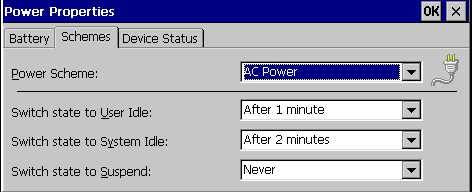

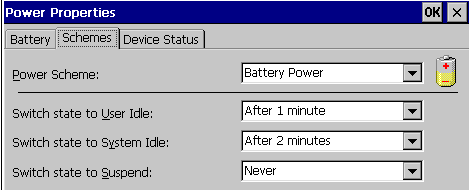

  5. Set WinCE timeout setting as followed for both AC and Battery power mode:
  6. Disconnected the USB cable and wait. (After removed the USB cable, USB clock will be turned off by freescale USB driver; after WinCE timeout to system IDLE mode, display will be turned off and ELCDIF clock will be turned off, the CPU will run into low work point from interrupt of OALTimerNotifyReschedule().)
  7. From debug serial port, you can see debug messages as “Setpoint HIGH”, “Setpoint MED”, “Setpoint LOW”.
