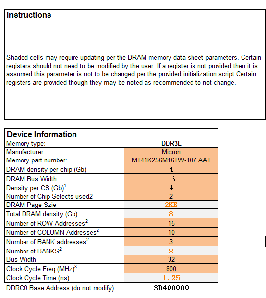

I designed a board with imx8m and 2 chips of DDR3L, part number is mt41k256m16tw-125 AAT, which could not be calibrated with MSCALE_DDR_Tool.
I used two CS signals and two CLK signals, CS0 and CLKA(CLKA_N/CLKA_P) for one DDR3L, CS1 and CLKB(CLKB_N/CLKB_P) for anohter DDR3L。
My question is how to set the MSCALE_DDR_Tool to pass the calibration? And if electrical connection is correct? The following PDF file is part of my schemtic for your reference.

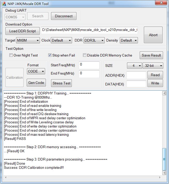

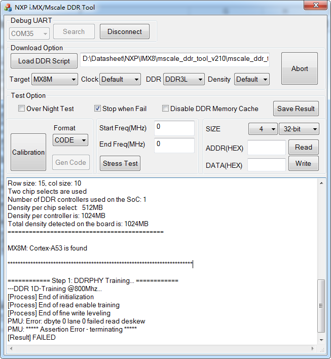

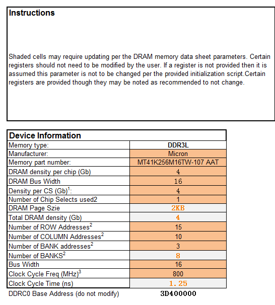

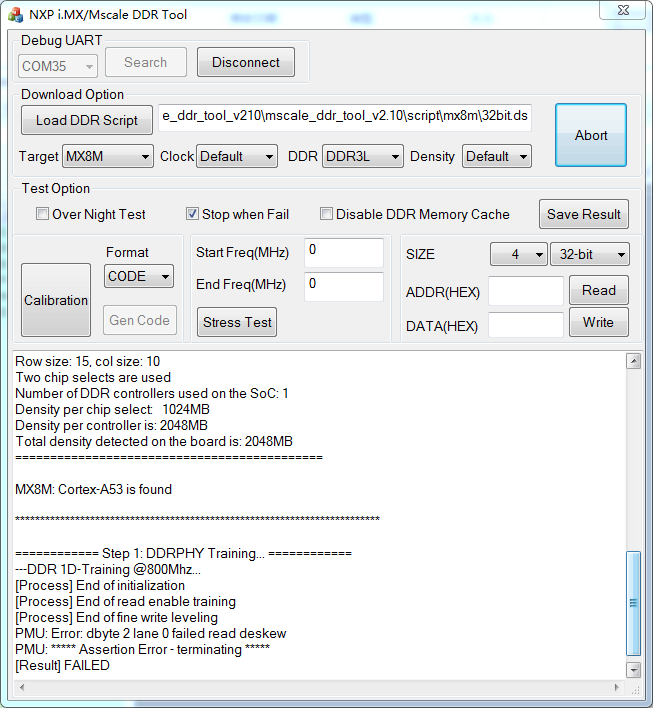

wawe
Hi igor,
    How can I set the "MX8M_DDR3L_RPA_v6.xlsx" file ,I tried so many times,but always fail. The follow pitcure1(16bit data width,two CS)and pitcure3(32bit data width,two CS) are my configuration, picture2 and picture4 are the DDR TOOL calibration resualt.
Finally, I found when configure one CS signal ,that is to say enable one ddr3 only, the calibration get passed. The following  is  screenshot.
I want to know how to configure the parameters to make two ddr3 chips work.Could you give me the direction?
Thank you for help.
Best regards.
