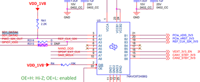

see imx8mp-evk-usdhc1-m2.dts
      usdhc1_pwrseq: usdhc1_pwrseq {
            compatible = "mmc-pwrseq-simple";
            reset-gpios = <&gpio2 6 GPIO_ACTIVE_LOW>;
&iomuxc {
      pinctrl_usdhc1: usdhc1grp {
            fsl,pins = <
                  MX8MP_IOMUXC_SD1_CLK__USDHC1_CLK    0x190
                  MX8MP_IOMUXC_SD1_CMD__USDHC1_CMD    0x1d0
                  MX8MP_IOMUXC_SD1_DATA0__USDHC1_DATA0      0x1d0
                  MX8MP_IOMUXC_SD1_DATA1__USDHC1_DATA1      0x1d0
                  MX8MP_IOMUXC_SD1_DATA2__USDHC1_DATA2      0x1d0
                  MX8MP_IOMUXC_SD1_DATA3__USDHC1_DATA3      0x1d0
                  MX8MP_IOMUXC_SD1_DATA4__GPIO2_IO06  0x19
                  MX8MP_IOMUXC_SD1_DATA7__GPIO2_IO09  0x1c4
MX8MP_IOMUXC_SD1_DATA4__GPIO2_IO06  , This seems to conflict with pcie's pin
EVB  SD1_DATA4 is connect to PCIE
&pcie{
      pinctrl-names = "default";
      pinctrl-0 = <&pinctrl_pcie>;
      disable-gpio = <&gpio2 6 GPIO_ACTIVE_LOW>;
      reset-gpio = <&gpio2 7 GPIO_ACTIVE_LOW>;
I modify dts..
            //reset-gpios = <&gpio2 6 GPIO_ACTIVE_LOW>;
            reset-gpios = <&gpio2 10 GPIO_ACTIVE_LOW>;
            status = "ok";
&iomuxc {
            fsl,pins = <
                  MX8MP_IOMUXC_SD1_CLK__USDHC1_CLK          0x190 //M2_SD_CLK
                  MX8MP_IOMUXC_SD1_CMD__USDHC1_CMD          0x1d0 //M2_SD_CMD
                  MX8MP_IOMUXC_SD1_DATA0__USDHC1_DATA0      0x1d0 //M2_SD_DATA0
                  //MX8MP_IOMUXC_SD1_DATA4__GPIO2_IO06      0x19
                  MX8MP_IOMUXC_SD1_RESET_B__GPIO2_IO10      0x41  //M2_SD_nRST
                  MX8MP_IOMUXC_SD1_DATA6__GPIO2_IO08  0x1c4 //M2_BT_WAKE_HOST
                  MX8MP_IOMUXC_SD1_DATA7__GPIO2_IO09  0x1c4 //M2_SD_WAKE_HOST
pcie not need disable
&pcie {
      //status = "disabled";
      /delete-node/ wifi_wake_host;
SDIO can be recognized without modifying the pre-programmed WIFI driver, and PCIE BUS can also be used
