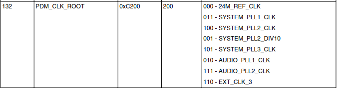

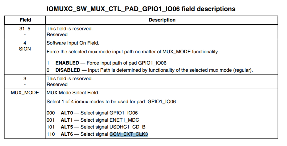

Customer would like have precise clock of PDM. Which pin is for input clock for EXT_CLK_3?
1,096 Views
AldoG
The input for CCM external clock 3 is the GPIO1_IO06 with the MUX_MODE [110]
