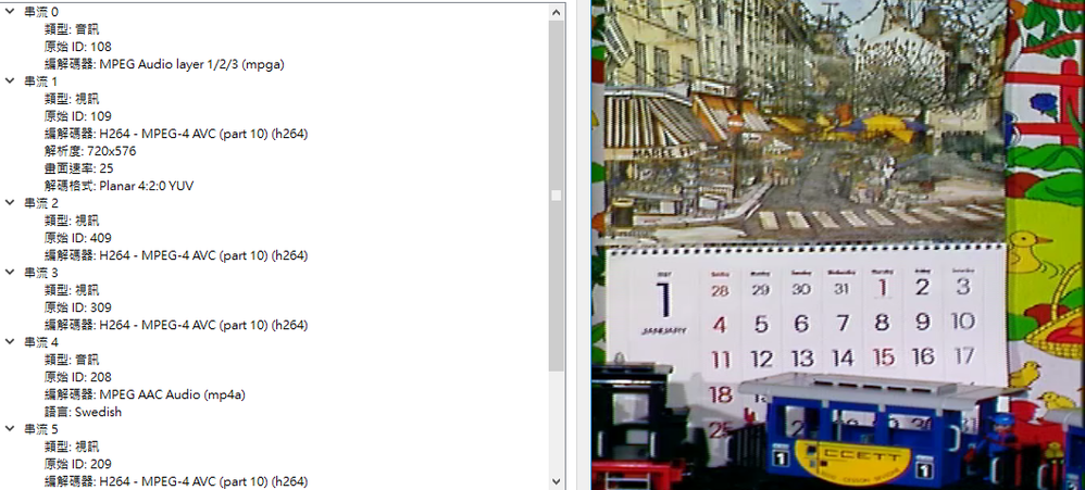

weikeng-jimmy
Hi Igor,
decode FAIL ->
decode OK ->

igorpadykov
Hi JIMMY
"FAIL" has SBR content which handled by HE-AAC which is not supported
by any Parser/Demuxers described in Table-27 Release Notes, supported only AAC as in "OK".
High-Efficiency Advanced Audio Coding - Wikipedia
igor
