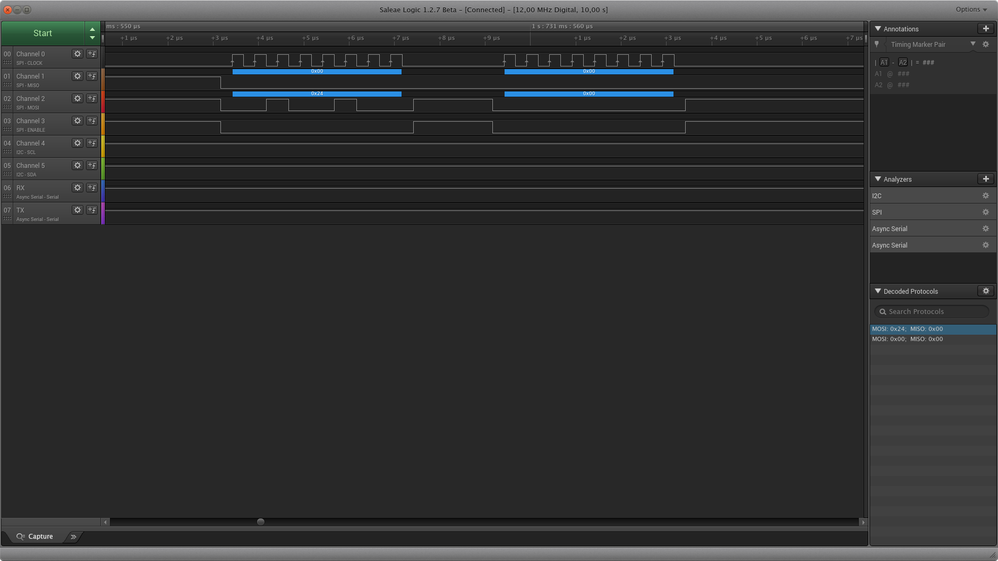

However, I still have a problem with the CS handling in the spidev driver. This is my method (SPI interface is configured elsewhere) :
IOBus_Error SPI::message(const unsigned char *txBuffer, unsigned char *rxBuffer, ssize_t &length, long flags) {
    IOBus_Error error = IOBus_Error_None;
    int status;
    if (handle <= 0) openHandle();
    // Build transfer
    struct spi_ioc_transfer    transfer;
    memset(&transfer, 0, sizeof(spi_ioc_transfer));
    transfer.tx_buf = (unsigned long)&txBuffer[0];
    transfer.rx_buf = (unsigned long)&rxBuffer[0];
    transfer.len = length;
    transfer.delay_usecs = 0;
    transfer.speed_hz = configuration.speed;
    transfer.bits_per_word = configuration.bits;
    transfer.cs_change = flags & SPI_Flag_CSChange;
    // Execute transfers
    status = ioctl(handle, SPI_IOC_MESSAGE(1), &transfer);
    // Check for errors
    if ( status < 0) return IOBus_Error_Write;
    return IOBus_Error_None;
For example, I want to read one byte at the address 0x24 of my device, so my buffers are the following :
txBuffer = {0x24, 0x00}
rxBuffer = {0x00, 0x00}
cs_change is set to 0 and length to 2

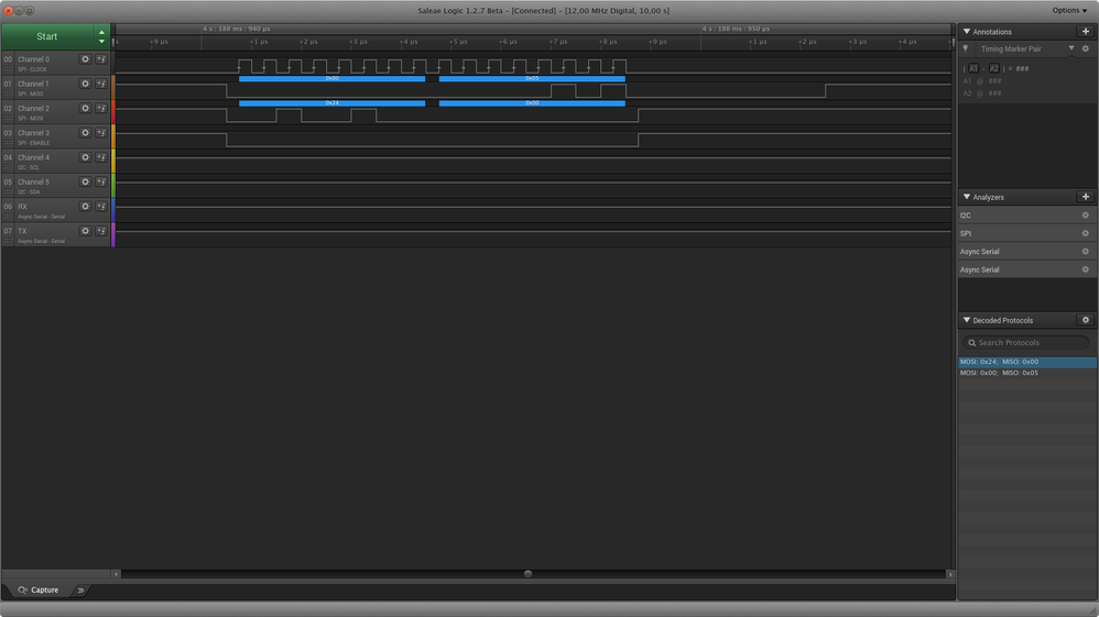

When I use my logic analyzer, I can see that the CS line is pulled up between the 0x24 and 0x00 bytes causing my device not to answer.
I then tried to use 16 bits per word in the SPI configuration to keep the CS line low, and it worked. But it is certainly not the way it has to be handled...
I also tried to set cs_change to 1 but it did not change anything on the CS line. And as I am aware of, cs_change must be 0 to let the CS line unselected between transfers.
Here is a capture of the wrong output on my logic analyzer :
And this is a capture of the wanted output using 16 bits per word, we can see that in this case my device correctly answers (0x05 is the value I was waiting for) :
What am I doing wrong ?
