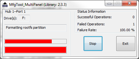

I'm trying to use the MfgTool2 to program a SDcard in the SD4 slot on the i.MX6SoloX SABRE Board for Smart Devices.
I am using the MfgTool2 in android_L5.0.0_1.0.0-ga_tools.
I get the following formatting rootfs partition error.
I would appreciate if someone can point out to me what I am doing wrong or what I need to configure.
Thank-you in advance for your help.
Kenneth
Original Attachment has been moved to: MfgTool.log.zip

HI Kenneth
for usage of mfg tools one can look at .vbs scripts, in this case -
mfgtool2-android-mx6sx-sabresd-sdcard.vbs
igor

kennethyu
Igor,
Thank-you for your response.
It had been very helpful.
I did not know until your response that "mmc" should be set to "3" for the SDcard on the i.MX6SoloX SABRE Board for Smart Devices' SD4 slot.
Kenneth
