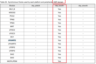

danielchen
Hi @wendy-liu :
LPUART2 is in DPS domain,  is designed for DSP core, not for CM33.  CM33 can not control it.
please check the reference manual.

danielchen
did you initialize the DSP core (Fusion_Init) before you call CLOCK_SetIpSrc?
