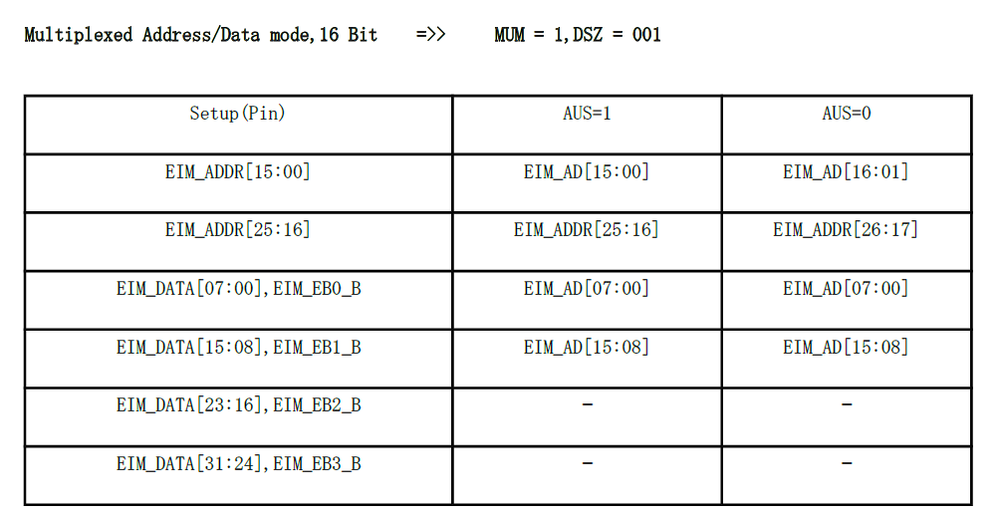

Dear all,
Please let me know about how to use EIM of i.MX6 DL/Solo
The page 1036 in a reference manual ( http://cache.freescale.com/files/32bit/doc/ref_manual/IMX6SDLRM.pdf )
About the function of bit23 (AUS) in 22.9.1 Chip Select n General Configuration Register 1 (EIM_CSnGCR1)
a)  in the case of  DSZ =  001 : 16 bit port resides on DATA[15:0]
                                 or  010 : 16 bit port resides on DATA[31:16]
b)  in the case of  DSZ =  011 : 32 bit port resides on DATA[31:0]
Is my understanding correct?

Hi George
yes correct, also it may be useful to check
sect.4.9.3.1 "EIM Interface Pads Allocation" IMX6SDLCEC

Dear chip,
Please let me know one more.
The information on an AUS bit is not included in Section 4.9.3.1 - Table 37.
Is my following understanding correct?

igorpadykov
Hi George
yes this understanding is correct.
