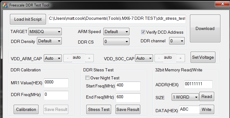

My settings are:

Error when Default is selected for DDR Density.
     Address of failure: 0x10000000
      Data was: 0x50000000
      But pattern should match address
      Error: failed to run stress test!!!
My setup (When error occurs during DDR Stress Test) is as follows:

Here is my setup (When No Errors 400 MHz - 475 MHz occur during DDR Stress Test):
The memory seems to be reading a 2GB density still, as previously shown in original post.
ARM Clock set to 1GHz
DDR configuration
BOOT_CFG3[5-4]: 0x00, Single DDR channel.
DDR type is DDR3
Data width: 64, bank num: 8
Row size: 15, col size: 10
Chip select CSD0 is used
Density per chip select: 2048MB
Why would the GUI interface have an error when I leave the DDR Density Default and operate when I choose the DDR Density as 1GB when it reads a Density of 2048?

from p.5 presentation:
"The Density information is obtained from the initscript. "
what is real density used on your board ? GUI just calculates data
from your script, if it is wrong please recheck script and enter valid data.
this may be related to : " No Errors 400 MHz - 475 MHz occur during DDR Stress Test"
- that is some range of memory (address lines) are excluded from test.
please use guideline from p.31 presentation:
"If using DDR3 and if you plan to run calibration, then it is important to fill out the MR1 value, like “0004”."
