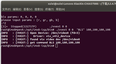

Thank you for your suggestion. I tried to use vvext to configure ISP these days, but I noticed that the parameters that vvext can configure are very limited. The key problem is that I don't even know whether the modified configuration can work normally, which seems not.

Dhruvit
Hi @LDX,
I hope you are doing well
Please refer to the below document for the information related to ISP sensor calibration parameters.
There is no such document available that can be used to tune the parameter using GStreamer.
