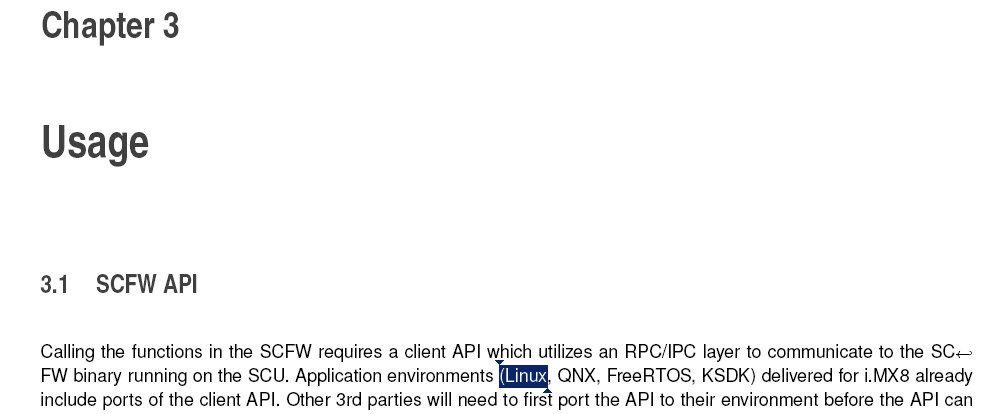

kumar_praveen
Thanks Igor for quick response.
Do you mean that I can use sc_irq_enable() to generate the interrupt at A35 and sc_irq_status() to read the IRQ value at M4?
Since SCU APIs are kernel library in Linux; do you have any suggestion on how to use it from user space?

kumar_praveen
Hi Igor,
As per my understanding, to access kernel library we shall create a driver / procfs / sysfs.
What we wanted to be sure that does NXP provides SCU driver for Linux or any procfs file, which can be used to access SCU APIs?
Is there any example in Linux OS, where application is using SCU APIs?
Praveen

igorpadykov
Hi Praveen
please read documentation included in SCFW Porting Kit ,
in particular   sc_fw_api.pdf
ipc.c\main\sc\imx\soc\drivers - linux-imx - i.MX Linux kernel
check also sect.2.2 System Controller Linux Manual in Linux 4.19.35_1.1.0 Documentation
igor

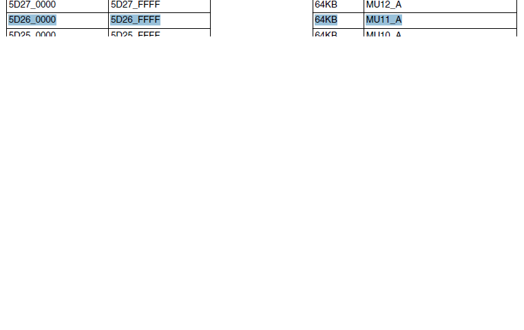

kumar_praveen
Hello Igor,
Waiting for your response for the above queries.
Further to that I have couple of more query:
  1. Per the Table 2.4 of IMX8 Reference Manual, the size of MU11_A is 64KB; Per section 12.9.4 there are 4 Tx, 4 Rx, 1 Status and 1 Control Registers of 32bits. Register size is just 40 bytes, the rest of the memory is used for what?
2. Why NVIC is only in Cortex M4 and SCU?
Praveen
