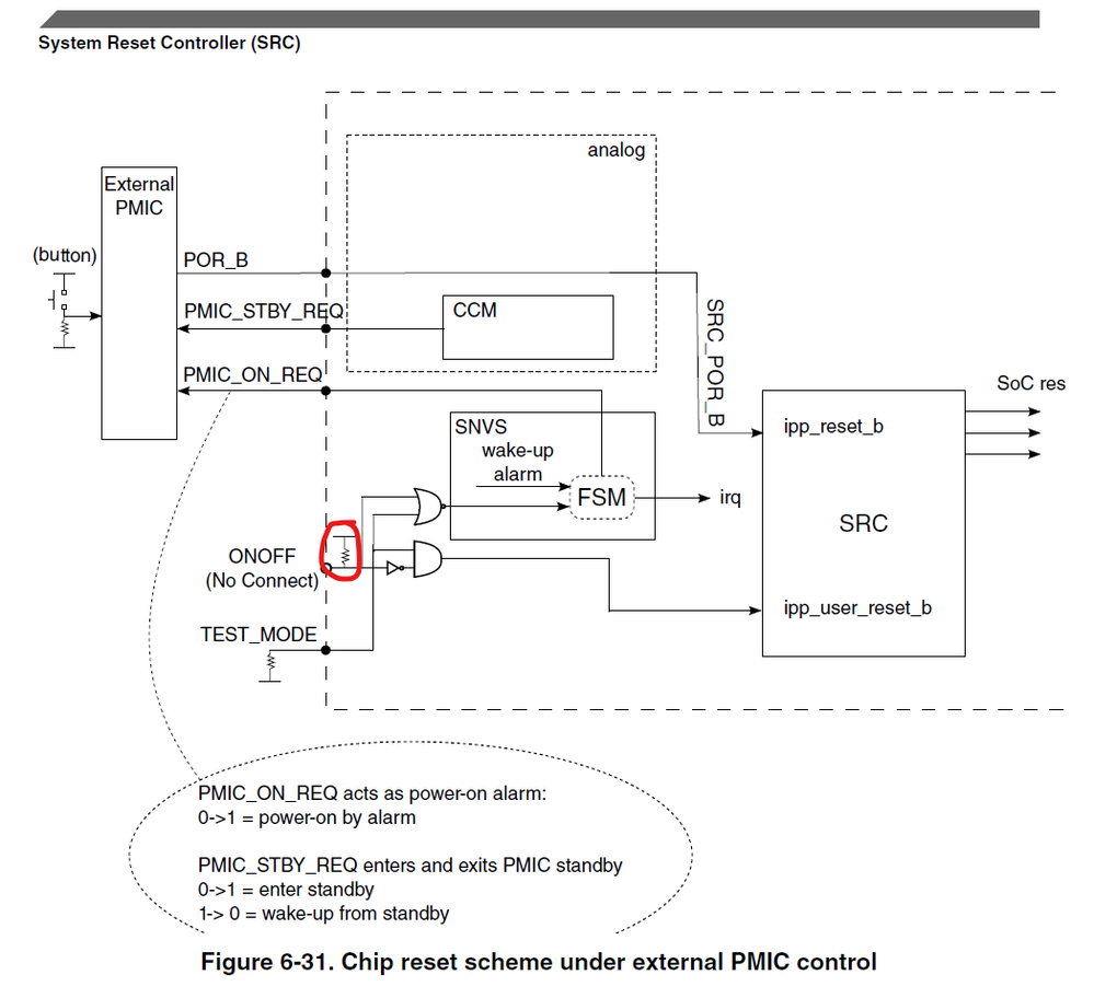

My design will be powering the 8M Mini using an external PMIC, so I don't need to use the ONOFF signal or PMIC_ON_REQ signal provided on the 8M Mini. How should these signals be terminated when they are unused?

Hi adevries
PMIC_ON_REQ may be left unconnected, ONOFF requires pullup
as described in Table 8. Reset and ON/OFF recommendations
i.MX 8M Mini Hardware Developer’s Guide

Hi Igor,
Thanks for the response. I will do that. However, I think Figure 6-31 in the reference manual is a bit misleading. I interpreted it as ONOFF having an internal pull-up, but it would appear that is not the case.
