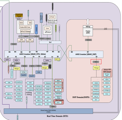

The clock of  LPSPI3 can only be controlled by RTD domain.It is highly unlikely that customers will be able to control LPSPI3 independently in the A35 domain.
The clocking scheme provides clear separation between Real Time Domain (RTD), Low Power Audio and Video (LPAV) domain
and Application Domain (AD). Except for a few clock sources shared between three domains, such as the System Oscillator clock,
and the Free Running Oscillator(FRO), clock sources and clock management are separated and contained within each domain.
RTD clock management consists of RTD _CGC, PCC0, PCC1, PCC2 and CMC0 modules.
Customer can only choose shared memory to let A35 access LPSPI3, can't realize peripherals mapping with PDAP( Peripheral Domain Access Permissions) between A35 and M33 domain because there is no such registers. There is only MBC registers about LPSPI3. I can't find spi-rpmsg driver in Linux kernel, so customer need write it.
If customer need to use LPSPI in A35, they should consider use LPSPI* in A35 domain.
