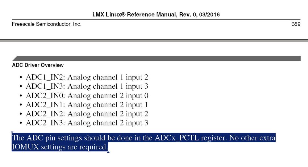

I need switch GPIO1_05 pad for ADC1 input purpose. I can't found mode number for IOMUX Controller neither manner how to switch relevant input keeper off, as it is mentioned in documentation.

Hi Marek
example can be found in arch/arm/boot/dts/imx6ul-14x14-ddr3-arm2.dts
http://git.freescale.com/git/cgit.cgi/imx/linux-imx.git/tree/arch/arm/boot/dts/imx6ul-14x14-ddr3-arm...
