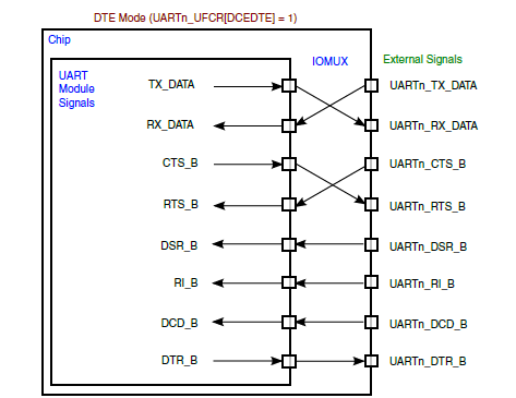

BiyongSUN
Please refer to  imx6ull-14x14-evk.dts
all the i.MX6 family use the same mechanism.
1. configure the IOMUX to swap the pin.
2. tell uart module  DTE or DCE mode.
please check the reference manual
690 &uart2 {
691         pinctrl-names = "default";
692         pinctrl-0 = <&pinctrl_uart2>;
693         fsl,uart-has-rtscts;
694         /* for DTE mode, add below change */
695         /* fsl,dte-mode; */
696         /* pinctrl-0 = <&pinctrl_uart2dte>; */
697         status = "okay";
698 };
3,726 Views

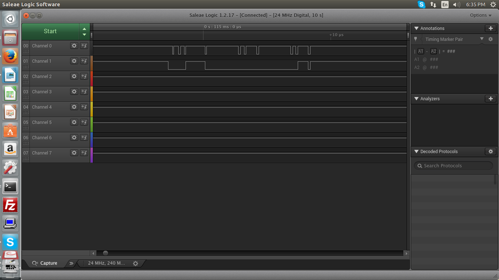

bhagavankoppaka
hi,
UART5:
In dtsi file: Changes Done
pinctrl_uart5: uart5grp {
fsl,pins = <
MX6QDL_PAD_CSI0_DAT14__UART5_TX_DATA 0X13059
MX6QDL_PAD_CSI0_DAT15__UART5_RX_DATA 0X13059
&uart5 {
pinctrl-0=<&pinctrl_uart5>;
compatible = "fsl,imx21-uart";
status = "okay";
Test Cases:
root@bhaggu:~# cat /proc/tty/driver/IMX-uart
serinfo:1.0 driver revision:
0: uart:IMX mmio:0x02020000 irq:58 tx:1219 rx:27 RTS|DTR|DSR|CD
4: uart:IMX mmio:0x021F4000 irq:62 tx:0 rx:0 DSR|CD
After Connecting Loopback(tx->rx) the results are as follows,
root@bhagguu:~# echo "bhagavan" > /dev/ttymxc4
0: uart:IMX mmio:0x02020000 irq:58 tx:1757 rx:121 RTS|DTR|DSR|CD
4: uart:IMX mmio:0x021F4000 irq:62 tx:20 rx:20 DSR|CD
logic analyzer o/p: when sending data # echo "bhagavan" > /dev/ttymxc4
The above response is what i am getting, but how can i justify that the UART is working properly or not?
is there any test cases to run in the target board to ensure UART is working properly?
is there any loopback test to perform so that i could see the data what i transmitted?
Thanks&Regards,
bhagavan.

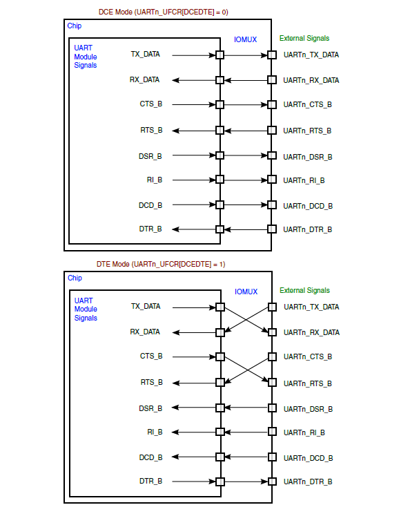

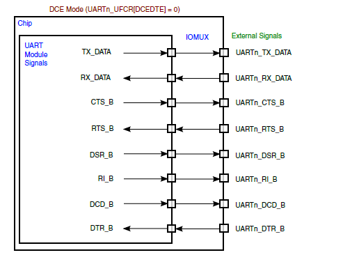

BiyongSUN
I did not see your dts tell i.MX6 it is DTE by the keyword fsl,dte-mode; which is in the binding guide.
It is very easy, just swap pin, tell the i.MX6 DCE or DTE mode as previous reply.
In you case,
DCE
fsl,pins = <
690 &uart5 {
692         pinctrl-0 = <&pinctrl_uart5>;
698 };
DTE:
pinctrl_uart5dte: uart5dtegrp {
fsl,pins = <
MX6QDL_PAD_CSI0_DAT14__UART5_RX_DATA 0X13059
MX6QDL_PAD_CSI0_DAT15__UART5_TX_DATA 0X13059
&uart5 {
         pinctrl-0 = <&pinctrl_uart5dte>;
          fsl,dte-mode;
        status = "okay";

angelo_d
Senior Contributor I
This is an old thread and helped a lot to finally clarify things.
Only one note. Picture with straight connections should be named DTE. Becouse internally cross-wired TX - > RX is tipical of a DCE device (modem) that received signals on TX.  Please correct me if i am wrong, it's just to clarify.
3,726 Views
BiyongSUN
understand your point. But it is i.MX6 special pin name and requirement. we ask designer follow the i.MX6 pin name. The same is for the ethernet connections. i.MX6 asks TX connect to TX phy side.  For the uart case, TX to TX the fifo inside the chip, which is not shown here in the diagram,  is RX to TX. For swap,  the IOMUX does the first swap for TX/RX, which need daisy iomux help and the "fsl,dte" is the second swap by the internal fifo.   I totally agree with you in the protocol layer. TX to RX is DCE.  TX to TX is DTE. But we need to follow the chip design and the BSP, right?
3,726 Views
angelo_d
Hi Biyong,
thanks for pointing out the reasons. This thread is really good, pictures here above clear any doubt and helps a lot.
So, if i understand properly, you have finally a dual swap. So if so, all is clear now.
Old guys knows that DTE to DTE requires a null-modem (swapped) cable, and DTE to DCE a straight one.
But for the current case, DTE and DCE are just names, and at the end is not even importand who is who. It's likely more important proper connection.
angelo
3,726 Views
