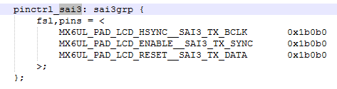

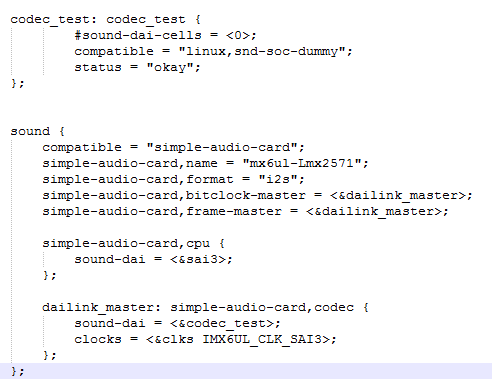

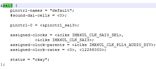

Hello:
      on my board, Lmx2571 is connected to the IMX6ULL's sai3.
   I have followed this post:
   i.MX7Dual + SGTL5000 no data on SAI output
   to added simple-audio-card on my baseline, but after do that , there is nothing show on my board.
   my dts file is like this:

Hi 国承 张
one can try "simple-audio-card" patch :
ARM: dts: imx6ul-14x14-evk: Add audio support - Patchwork
igor

guochgz
thanks igor, I have solved this issue by add code in soc-util.c.
