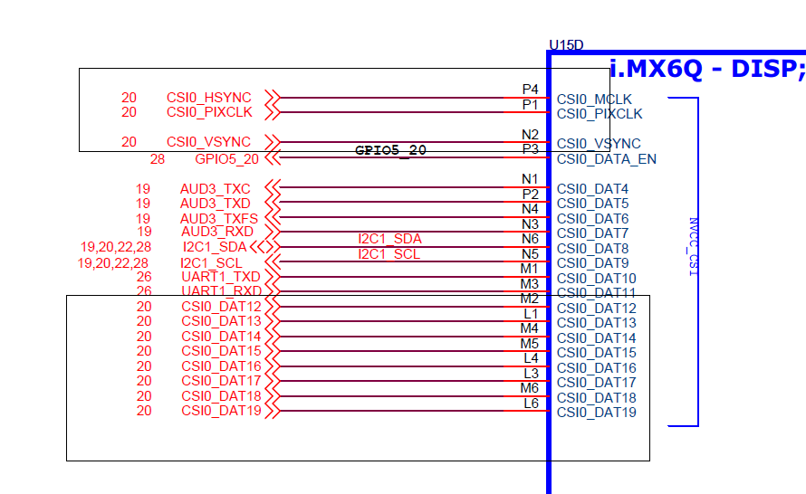

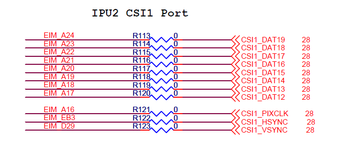

  Hello,everyone.
  I want to use two cammer at the same time on Linux. If I want to use one parallel and one serial cammer,how to build the BSP. Can I use two parallel cammer at the same time?
标签 (1)
1 解答
1,174 次查看
weidong_sun
Hello,liaoyuan,
     On mx6q-sabreSDP board, 2 cameras are supported , one is parallel bus (CSI0) , the other is serial bus(MIPI), so you can compile BSP and drivers according to user's guide. 2 cameras have been supported in BSP.
     In addition, you can used parallel interface for camera at same time : CSI0 and IPU2_CS1. See following schematic:
